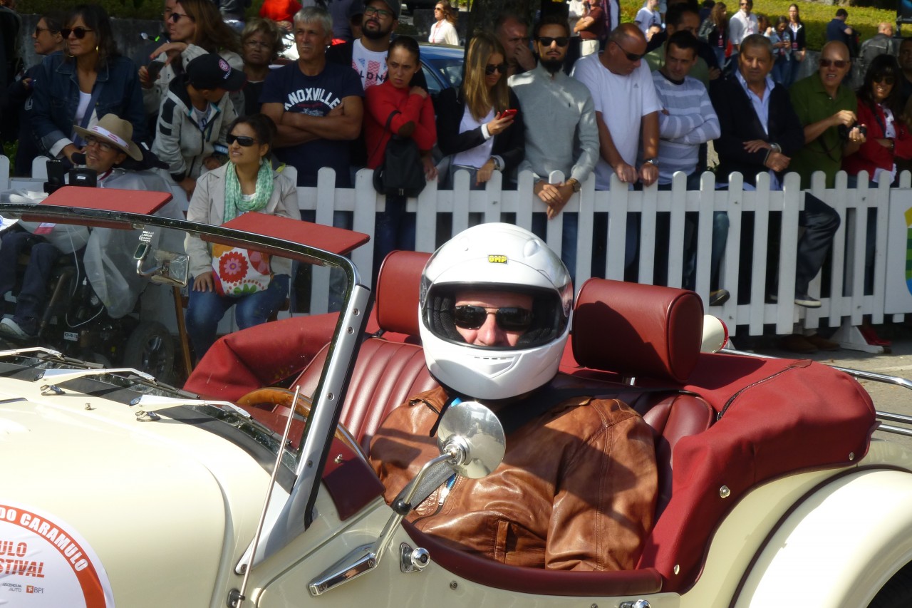

When you fold the toneau cover pul it back over the back of the car and fold in the sides to make a triangle with the point towards the rear. You then roll the cover and tuck it behind the seat.
The best thing is to have two extra zips fitted to the toneau cover. The side sections can then be tucked behind the seats and the centre section folded and rolled as described above. That does a better job of leaving the seat belt run more free.
I thought I had posted some photos when the job was done but I can't find them at the moment.
You do see it folded and tucked away in the photo below. I will get some more photos and post them on the weekend.
