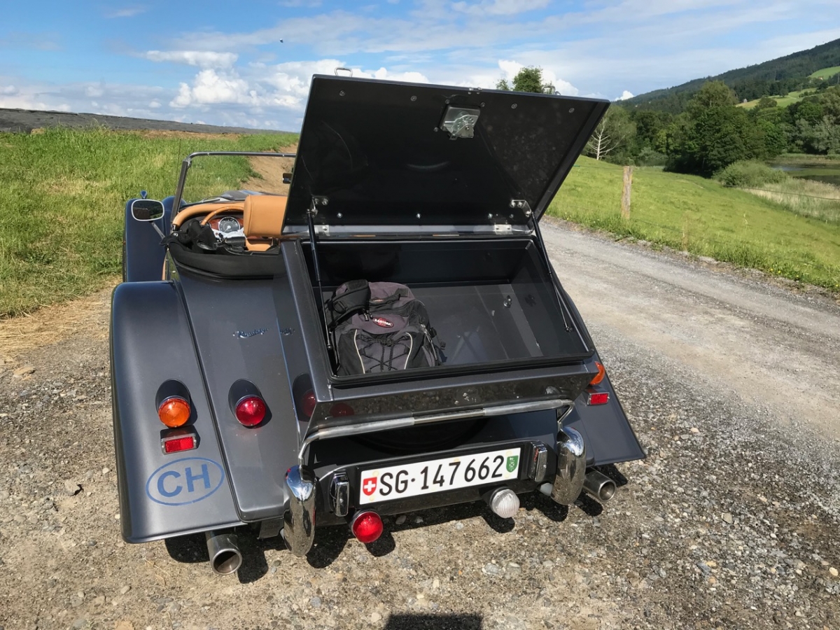

Custom made storage box for luggage rack
Hello Together

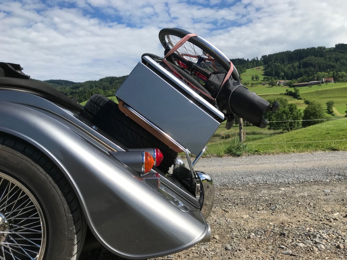

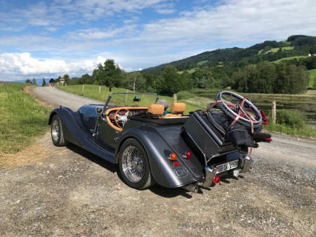

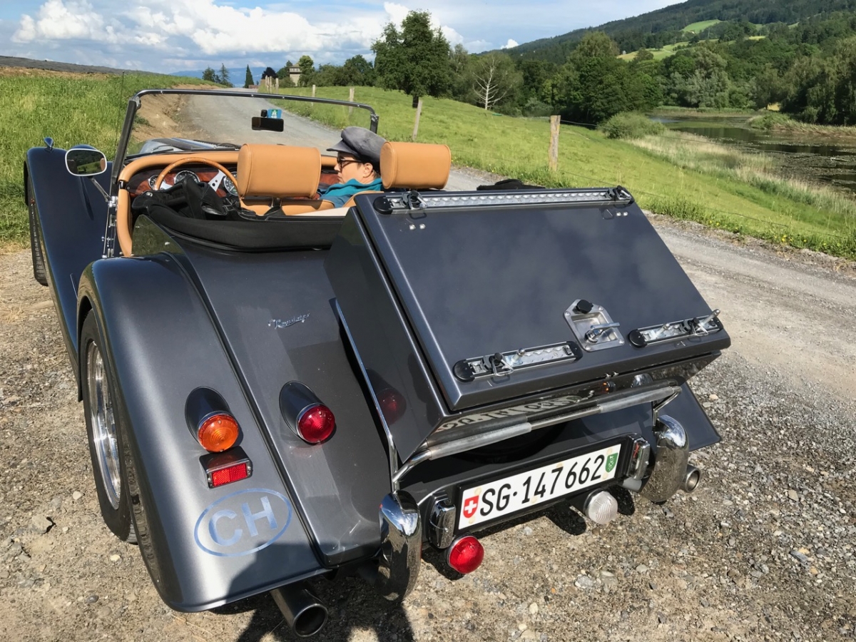

I know we all love this leather suitcase for the luggage but if you make a road trip sometimes you will leave your baggage in the car and have the possibility to lock it. Searched quite a long time for a solution but didn't find one. Therefore I buy a custom made aluminium box with the dimensions 800x500x250mm and a door lock. Painted it in car colour and mounted it with two wood bars on the luggage rack. Because we have to take the wheelchair from my girlfriend with us I added aluminium profiles on top of the cover. Not so nice to view but it protects the cover and allows me to secure the wheelchair very quickly.
The box cost me about 450€ for the box itself 270€ for the painting and some bucks for the wood and the screws.
Just want to let you know if someone searches for a similar solution
René
