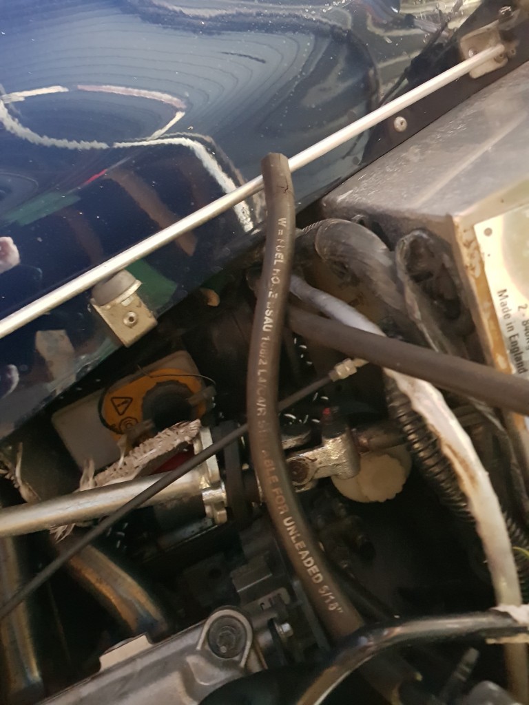

When I checked again all the hoses I saw on the underside the hose from the valve that releases vapour from the fuel tank was perished. Overall it is stiff & brittle.
Tonight I used gaffer tape to wrap the hose and the fault is again reduced & the car even smoother and swifter. But the gaffer tape slips off due to the engine heat
Thursday I will fit a piece of 5/16 ths hose.

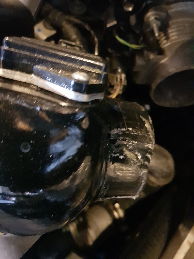

The saga continues I decided to make a start taking off ever hose & checking them.
When I removed the hose connecting the airbox to the throttle body it showed that the fibreglass had deteriorated & broken apart where the jubilee clip fits.
I hope that is the culprit and will get a fibreglass repair kit tomorrow to work on it.

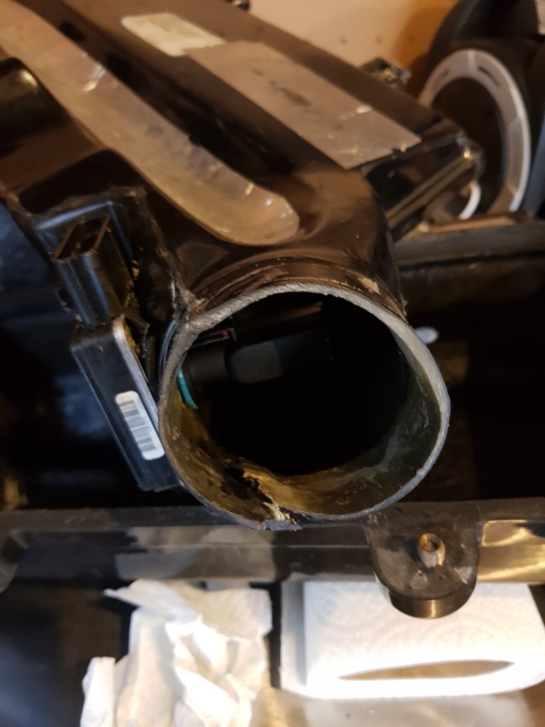

And a better photo of the failure

So do I. The problem is the airbox vibrates a lot due to the way MMC fitted it.
Hopefully next week we will see a result.
