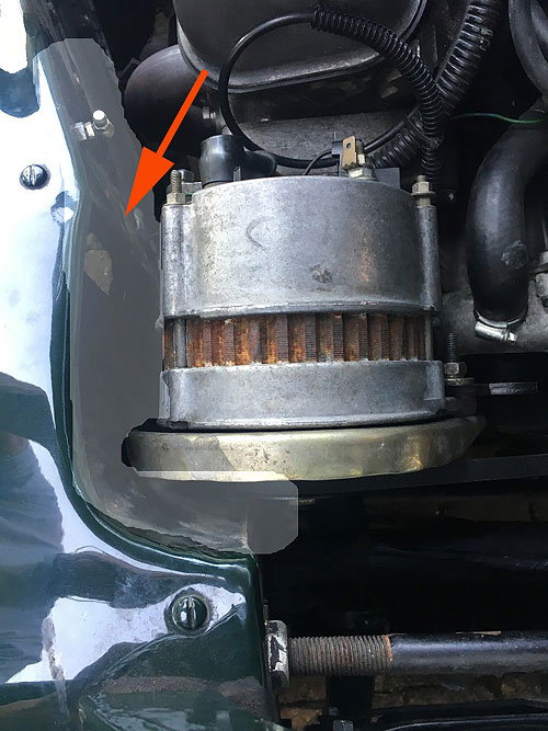

Received this from a friend today which may help you out a bit. I couldn't proffer any help myself as both my Plus 8's were nothing like this arrangement and no information is better than duff information in my book.
Thanks to Lorne for going the extra mile on this one thumbs.
8 alternator bolt is accessed through a slot Morgan made through the adjacent valence. Other wise, one has to laboriously remove the bracket the alternator is attached to..which has three bolts, two visible from
the top and another hidden at the bottom. That is not only fiddly, but dangerous as it leaves one very awkwardly. holding the heavy alternator and this huge bracket, both removing it and reinstalling it.
http://www.gomog.com/allmorgan/GMalternator.html#WATCHPOINT

I find out from GOMOG that there was a slot cut in the inner wing to gain access to this bolt. Doesn't look like the alt mount I have in spares.

Yes, it's nothing like my 1999 either.

Mr Button, I suspect there were quite a few different alternator mounts used over the years on the Buick/Rover V8 engine. I looked in the Rover SD1 manual Lorne sent me years ago and the alternator mount it shows is nothing like the one on my Morgan.. But hopefully CJB has enough info to get into the task, if he gets into difficulties it seems there are folk here keen to help out.. (-:

On my 1995 Plus 8 the alternator bracket is a Morgan item, says Morgan on the bracket, so not a SD1 or LR item
