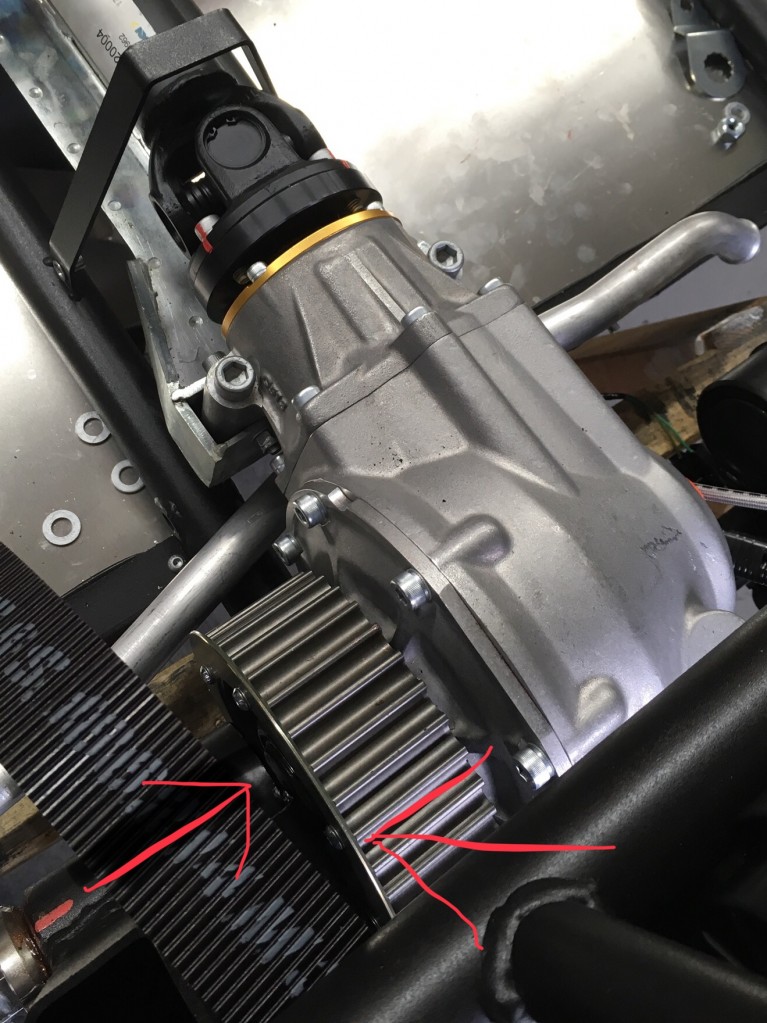

Little plate on bevel box output gear fell off! All but one of the mounting bolts sheared off and was rattling around, so we removed it but the belt would not run in a straight line so recovery trucked home for further investigation ๐Ÿ˜Ž

Is this the plate youโ€™re referring to Kev?

Thats the offending article Rich! Got a few things to try out to rectify the cause of problem, but i think we should be running again soon....
