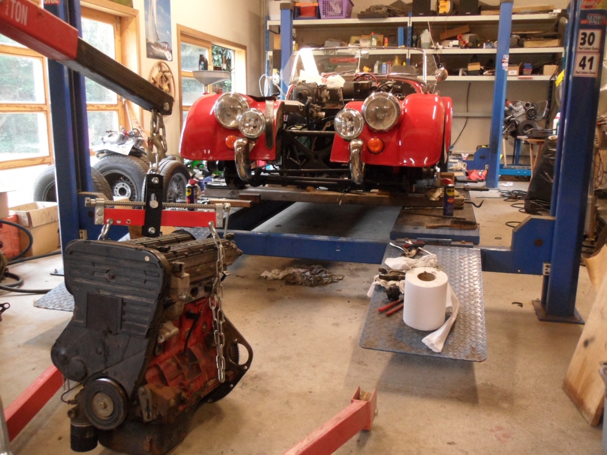

Everything bolted, engine runs and i have a clutch ! … But a water leak. Some heated part below the throttle body....must look what that is and gaskets … must be due manipulation , got the inlet manifold aside with those small water hoses connected. But i do see some old residue from leaking ... Pitty , as tomorrow nice weather for a test drive... as we don't drive it in winter temp's perhaps i can bypass that part ?? ( Rover M16 )
