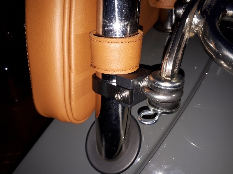

Originally Posted by Mark H
Originally Posted by skullmog
They look fantastic Mark where they come from?
Kev - I've used the following & it added up to £29
39mm Truss clamps eBay £14
Stainless eye bolts £ 5
Classic mini rocker cover rubbers & washer kit
eBay £10
Stable, cushioned, removable and it works, the clamps stay attached to the rack when not in use, no drilling or badly designed fitting to install
I used the mini rocker cover kit and 8mm eye bolts too but found these really neat clamps on eBay.
Item number 193085473161

Does it not crush the body panel with the weight on the suction cup ?
The area of contact is a complex curved surface, probably the strongest part of the whole cars skin.
Only if you have a loaded top box and accidentally take a NZ speed bump at speed like Richard H! 😊
