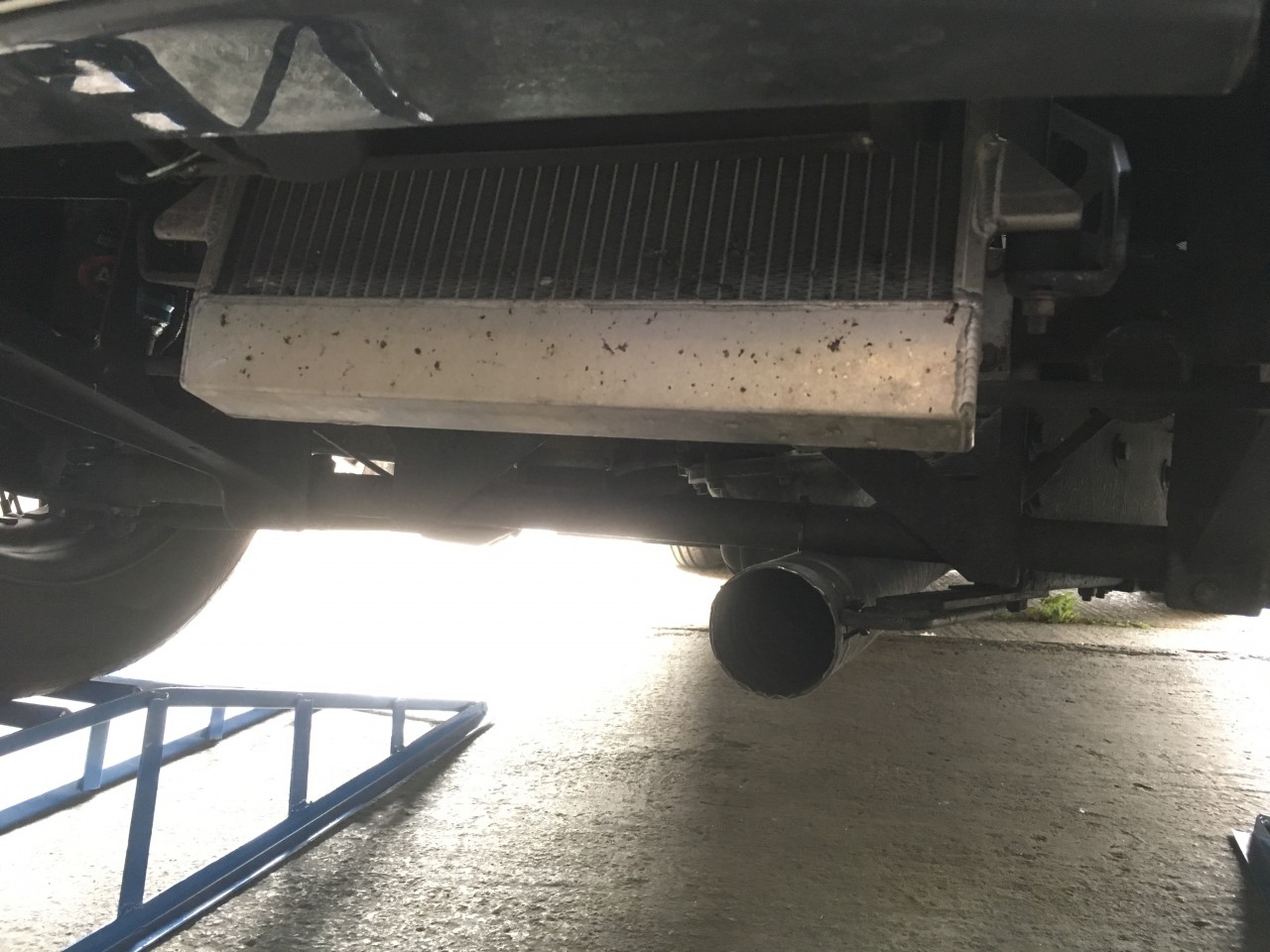

Quite good and effective result. MAF sensor shows the same value as the outside temperature, today it was 18 degrees C. After a red light temp is down again after 30 seconds. No more an issue concerning the negative pressure situation with this placement of the open air filter. At the entrance of the hose I will attach a kind of fly screen against stones next weekend. The product/hose is a HJS (the catalyst manufacturer) "preheating hose" for exhaust systems, it measures 70mm diameter and it is one meter long, I cut some 15 cm away and perhaps I will do so a bit more in case the end is to close to the filter which I will check. I think there are no problems regarding the low positioned input of the hose. So cold air is coming in for sure. The filter can be cleaned easily.
I left the original air box in place as you can see because I use it with the original metal tube when we do long tours e.g. to Italy because it's quieter. The change only takes 10 minutes. For weekend trips the open air filter is very good and the 4/4 is driving as fast as it‘s stolen.

Nice idea and material selection, besides the different temp measured, any change in how engine improved? Dud you have a specific complaint, other than high temp read out?

Bert, the spontaneity of the throttle response and the performance is noticeably better with the new air hose. Without the hose the open K&N is already good. But now the third gear pulls up to 145 km/h like a rubber band.
Actually this position of the filter is a low-pressure area. In principle this is not optimal. Therefore the additional hose.
What I would like to try out is the correct distance from the end of the hose to the air filter. But this is only a fine tuning for very high speeds which I normally do not drive with the 4/4 anyway. I'd say it's very good up to 150 km/h now. If the car drives faster, my 4/4 manages GPS measured 190 km/h on the straight motorway, it can be that the air from the hose becomes too fast and thus undesirable turbulences develop at the air filter, which can have an opposite effect. K&N writes that the cold air hose should not be closer than 10 cm to the filter.
