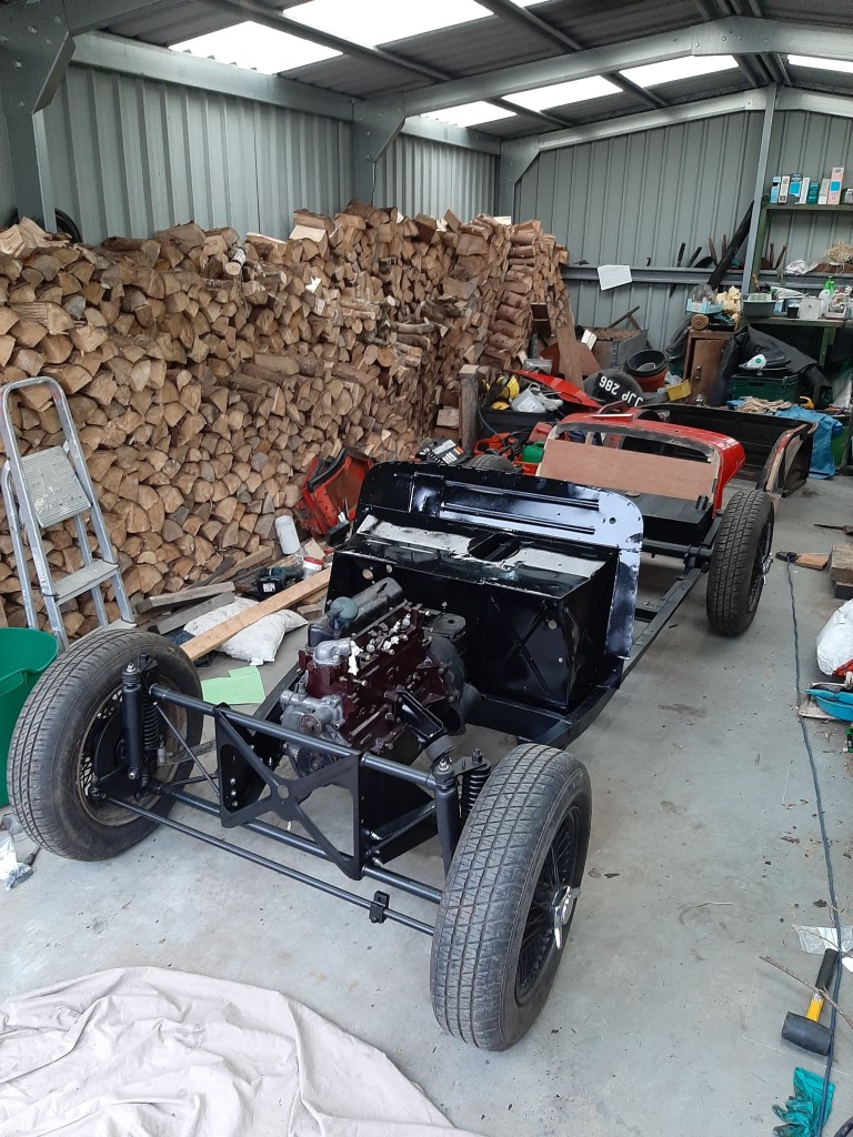

Image #636076 08/05/20 07:00 PM
Posts: 5,587
Likes: 603
Image Offline OP
Posts: 5,587
Likes: 603
Decent day's work ..... new clutch kit installed...gearbox bolted up and all dropped into the chassis ..... won't post pics of my dodgy engine hoisting extravaganza so as not to upset the mechanically sensitive .... Happy with that ....cuppa and a sit down now!
Bulkhead just sitting there as it's the most convenient place to store it at present .... bolting it in with plenty of mastic is a job for the very near future .
Ps ...not keeping the rocker cover ....if anyone has an alloy one they keep tripping over and want to part with, let me know

Image #636109 08/05/20 08:43 PM
Posts: 5,442
Likes: 468
Posts: 5,442
Likes: 468
K, in the off chance you may not be aware it has been normal in times past for the body to be isolated from the chassis by a layer of tar type DPC which I believe exists to allow a degree of flex betwixt them both without damaging the chassis paint and allowing corrosion access to bare metal and the process of corrosion to begin all over again...? But then you probably know that...Just did not want to take the chance of you missing that..err...trick.
Of course modern sealants might perform better. I think my floor boards may also be bedded in on sealant and their edges likewise treated prior to assembly. Kevin the chap who rebuilt what was his car (now mine) did so with years of professional experience of repairing and restoring corroded Morgans.. My car has all stainless nuts and bolts which makes taking things apart so much simpler, if and when the need arises..
Image #636110 08/05/20 08:50 PM
Posts: 5,587
Likes: 603
Image Offline OP
Posts: 5,587
Likes: 603
Rich .... thanks ... yep, she proved invaluable yet again (not sure I spelled 'gullible' right smile )
Luddite .... indeed ... the remains of the bitumen felt dpc was still on some of the wood...this will be replaced as I get to mounting the tub .... will be using mastic between the bulkhead and chassis to seal the join ....and likewise on all the double-skin areas of the inner wings .... hopefully it will keep the water out and hold together long enough to see me past my driving days smile
Image #636116 08/05/20 09:11 PM
Joined: Apr 2016
Posts: 2,519
Likes: 320
miles of smiles
miles of smiles
Joined: Apr 2016
Posts: 2,519
Likes: 320
Amazing progress, the engine is looking sweet, you’re right about the rocker cover though, it’s needing a Burton alloy one for sure. How’s the sumps ground clearance in the Morgan? The same engine in my 7 is subjected to frequent scuds and scrapes to the sump.
Image #636119 08/05/20 09:26 PM

Image #636120 08/05/20 09:32 PM
Posts: 5,587
Likes: 603
Image Offline OP
Posts: 5,587
Likes: 603
ewn .... without everything loaded the suspension is sitting high so currently a medium sized sheep could walk under it .... the way the engine sits the bottom of the sump sits a few mm above the chassis rails so things would have to get pretty desperate to scrape the sump smile
There must have been a gazillion alloy rocker covers sold to boy-racers back in the day ...thinking I'll look around for a 'period' one first ....but Burton will be a good fallback if I can't find one ....after the trials of the demon woodwork I'm loving this bolting stuff together bit!!.
Good to see you the other day ....hopefully we can get out for a drive about when this rebuild is finished
