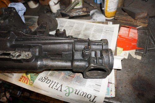

Here's the reversing switch on a type 9 tail shaft case.

TBM .... I'll have a look (tho there are probably 5 speed Type9 gurus on here will know off the tops of their heads) ..... if there isn't one integral to the box I reckon it wouldn't be too hard to rig a micro switch to be operated by the gear lever in that position ..... will be checking out the wiring loom tomorrow so will look then.
https://www.burtonpower.com/reverse-switch-types-2-3-5-9-e-f-not-2000e-gbt9545.html
I've not got a wiring diagram for a Mark 1 Capri or Escort but as the switch is available you'd think there's be somewhere to fit it on the gearbox. I'd guess that the reversing lights were an optional extra on cars of this vintage and Morgans just bought the base item.

It's the same on mine as in the pic John posted ...... looking on the Ford forums it appears there are two types of switch and the reversing light is earth activated ..... the single connector switch (which presumably earths internally when operated) which is now really hard to get ....and the double connector switch as in the picture that just needs one connector tagged to earth ...Possibly using the gear lever mounting bolt just above it.

That's great thank you - I wonder if there's not enough space between the gearbox and tunnel? At least now I know where it is I can see if I can wire something up. May have to cut an access hole smile
