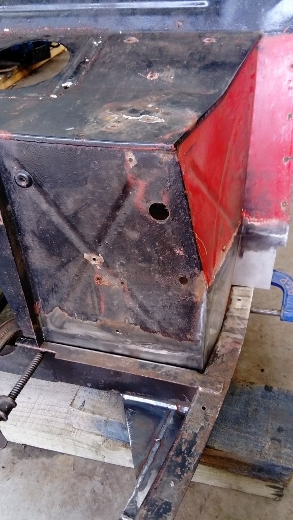

Last patch in the 'underpinnings'.... Passenger side inner wing...... Sometimes Morgan shoot themselves in the foot... See how the pressed strengthening rib forms a tube guiding water straight into the join between the inner wing and bulkhead when it's bolted together... Corrosion death-wish.... Will pack that with mastic on assembly. Dummy build next thing but have a few day's to wait for the last of the wood so will clean and paint the fuel tank and rear axle while I'm waiting.
