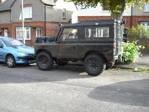

13" on mine - bit more space and no issues with steering. Saying that, i used to run a S2A Land Rover with rather large tyres, on a 14" steering wheel so it may be said I have reasonable 'upper body strength'
Nice Landy!! grin2
