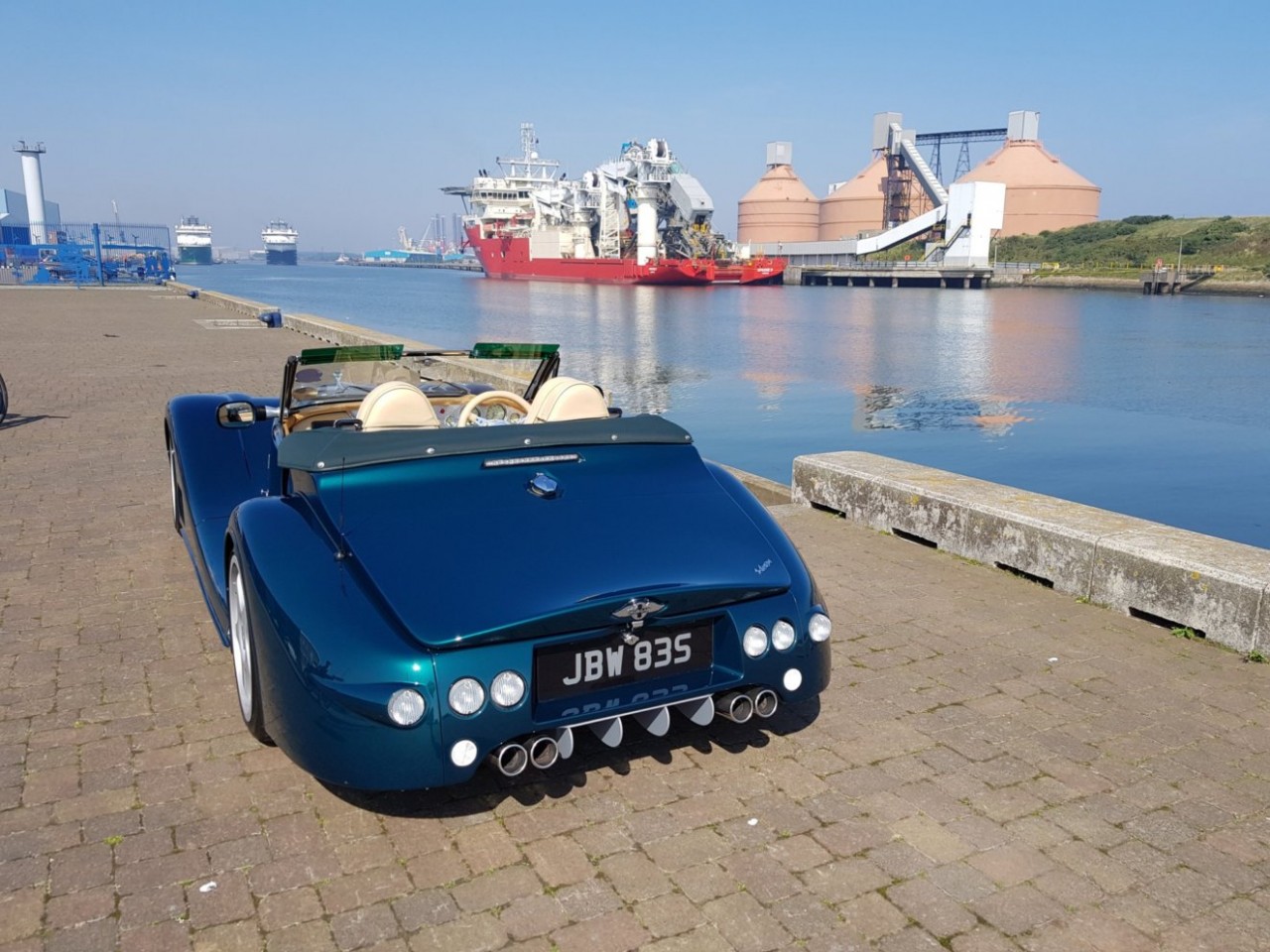

- an Aero8 (obviously!), but coloured lenses swapped out for clear, together with clear LED's which light up in the correct colour.
You may (will....) need to add resistors to the indicators if they flash too quickly.
Personally, I don't like the amber/yellow bulbs in clear lenses as it gives the infamous 'fried egg' look nono
Reflectors have a red 'tinge' to them but should be full red for MOT time..... innocent
