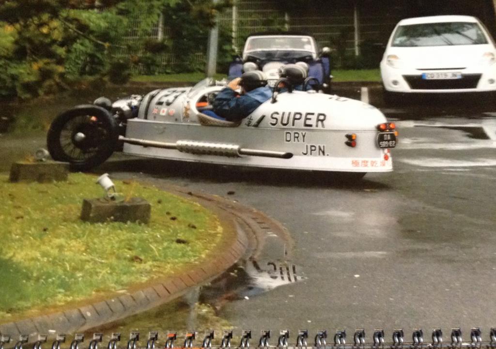

Montlhery revival 2019
Vinmog calendar july 2020
Mudguard not a necesity
