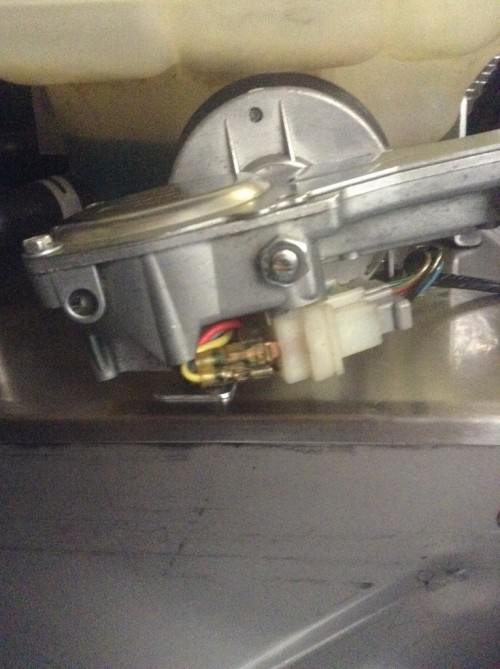

Bit of useless info from my personal maintenance log. Ages ago I got fed up with the windscreen wiper blades falling off the bottom of the windscreen. Remedial action was required...
PART A
The sweep of my wipers was 130 degrees (the norm I believe), controlled by the wiper drive gear within the wiper motor. A replacement gear was necessary.
I determined 115 or 120 degrees would be better but my local supplier (Leacy) only had 105 degrees at the time which I took for about a tenner. Fitting was very straight forward if a little messy due to the grease. But, replacing the bottom circlip is a “b*****.
The result is excellent though 115 degrees would probably be even more excellent.
PART B
Whilst fitting I noticed a nasty gouge in the stainless below the wiper motor and realised the wiper motor gear wheel shaft was actually sitting on the stainless, bumping or grinding out of sight.
Altering the attitude of the motor is difficult due to (a) the angle of the drive cable and (b) the cooling system expansion tank sitting right on top of the wiper motor U bracket.
Temporarily I fitted a small stainless plate to act as a bearing surface and although I planned to do a more permanent fix I must admit I never did. At every service I inspect and change the plate if necessary (2 so far!)
I hope the picci explains; the “temporary” plate is beneath the yellow wire.
So, no annoying wipers and one less rattle and bang
I hope this helps someone
Regards
Geof

With the original 130 gear my 7" blades swept 50mm from top frame but dropped off the lower frame by about 7mm on full sweep (driver side).
With the 105 gear no change at top but 25mm clearance from blade bottom to frame. This is why a gear about 120 would be even better allowing more sweep and still allowing frame clearance using 7" blades.
But Cooperman's (and probably CBS) excellent mod 8" blades would be perfect with my 105 gear with no cutting down and will be used when I replace my blades.
I must stress these details apply to my car with a drop down windscreen. I'm reliably told however it's the same screen and rake as "ordinary"cars.

Firstly apologies. I misread my rough notes. The distance from blade to screen frame should read 30mm at top of sweep.
You are quite right, whatever distance you have at the top will remain no matter what gear is used (providing the blade length is not altered). And yes, the bottom distance decreases as the sweep is increased.
Recommendations. If I'm pushed and strictly E &OE...
For 7" blades I'm sure 120 is ok but 115 gives a bit of tolerance.
For 8" blades 105 is clearly ok. There is tolerance but I don't have the drawing skills to plot and measure the bottom position of the blade as the sweep increases.Not forgetting of course the end sweep position will also change with the blade position on the spindle.
The 105 gear from Leacy is no 37H3045.
CBS seem to be the same item
Is that ok?
If you want a piccie of 105 blade positions let me know.
