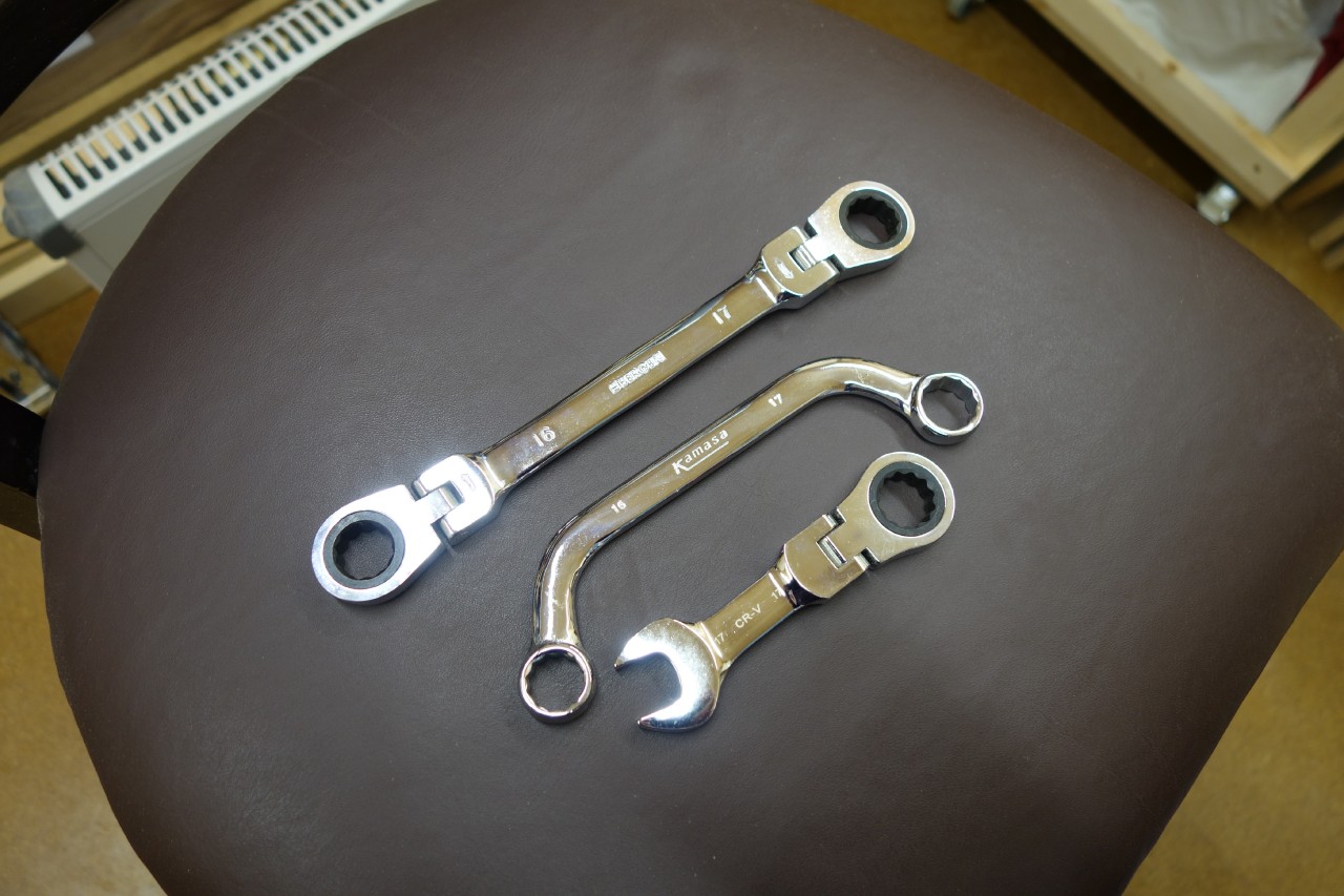

First thanks for the excellent information on the “Replacing Seat Belt on a 2007 +4” (or similar title) it was a great help. Turned out on my 2009 +4 that the bolt and nut are both 17mm although I didn’t discover that until it was out before that it had looked like the bolt was 18mm, even with modified spanners and a helpful neighbour with hands like a gynaecologist stopping the bolt from turning was a nightmare, we eventually stopped it turning by getting a large screwdriver in between the seatbelt base and mounting bracket from the bulkhead side and “lifting” the seatbelt to put pressure on the bolt to stop it turning, once removed it could be seen that the nut was Loctite’d on.

FDTS for sure - mine went there this morning. My bolt was 17mm and the nut 18. I managed to get the bolt head held in place with a double-ended cranked spanner that I'd bought as a set some year ago They'd lain unused until now. The stubby wouldn't go over the bolt head and neither would the long ratchet spanner. The 18mm one worked fine on the nut.

I talked to them this morning and the belt is now boxed up ready to go off tomorrow, I ordered a stubby ratchet spanner as Roady so hopefully that will work on the tightening up.
