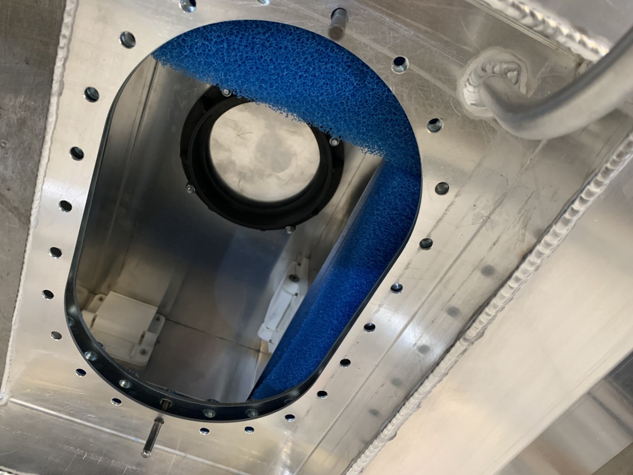

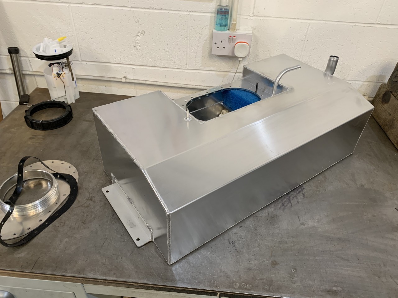

.....and to keep all you chaps entertained with some aluminium welding goodness.
Finished this +4 Clubsport full competition foam filled fuel tank off for the factory a couple of weeks ago
It has a baffle box with trapdoors fitted around the in tank pump
Both the trapdoors and the fuel pump locating ring are 3D printed
The foam is an explosion suppressant should the car be involved in an accident
Simon @ SiFab.co.uk
