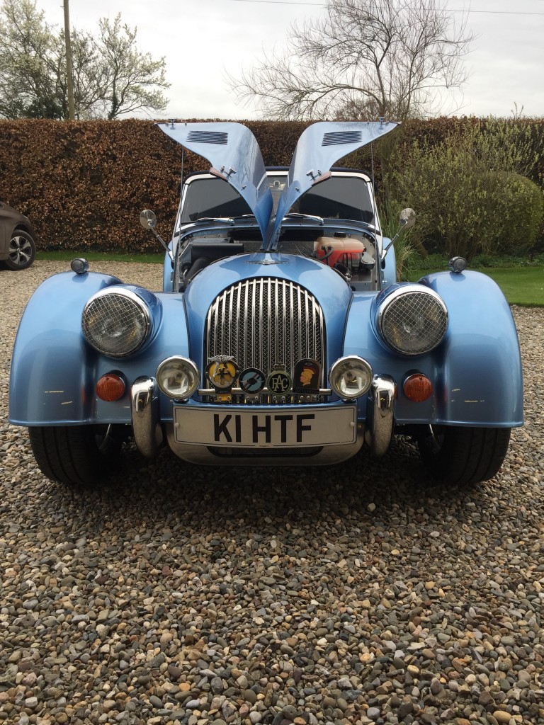

An alternative is to use the number plate box for spotlight fixing.
I inherited this set up which initially was a tad wobbly and the spotlights pointed skywards. The box has now been internally stiffened with tough plastic ribs and fibreglass resin.
Angled aluminium spacer blocks were fabricated to bring the front of the box to a vertical plane. More spacer blocks were fabricated to move the over riders forward by 25mm.
Whatever floats your boat...

Love yer work there Chris, however, the headlight grills would drive me mad at that jaunty angle??
