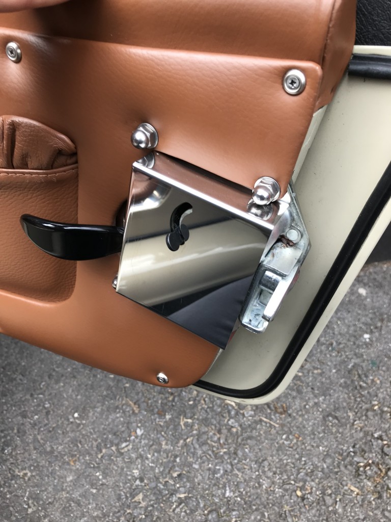

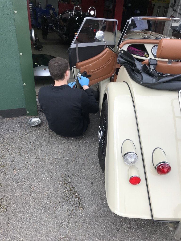

I had mine fitted at Williams 2 years ago, I didn’t think they did remove the door cards, but in the first image it looks like it was removed slightly?
