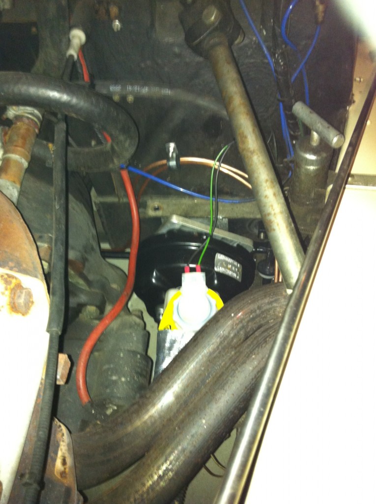

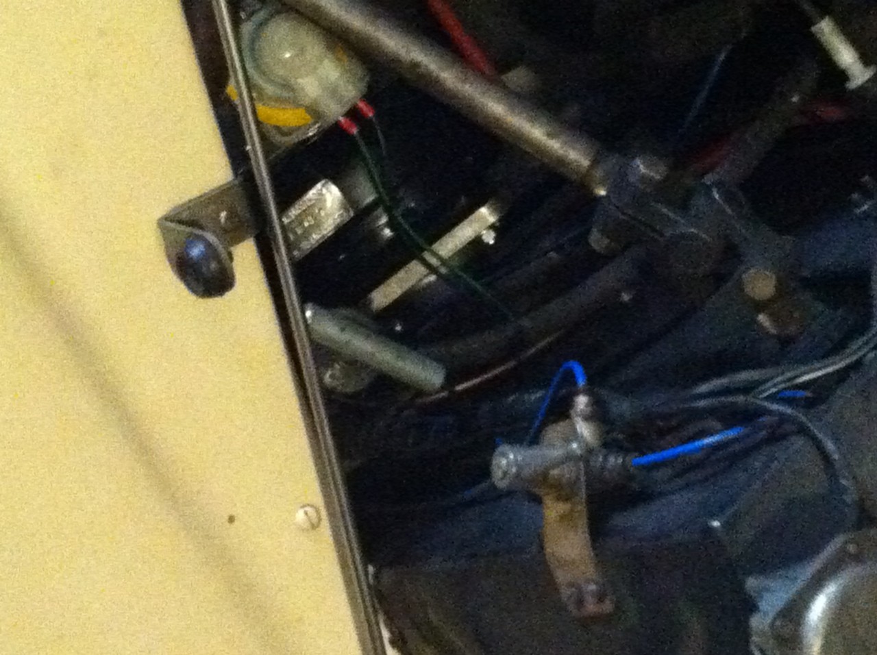

I have a central remote grease "pot" with tylen hoses for the upper nipples, and a switch to select left or right! Works very well for many years, lower nipples by hand and not so often...!

That's a neat idea Ruut.
Saves carrying a grease gun for those long trips away.

Ruut,
how does it cope with the engine heat. Doesn't the grease melt or do you use a higher melting point grease.

I use PM Petromark MoS2 EP-2 grease. No problems with engine heat so far!
