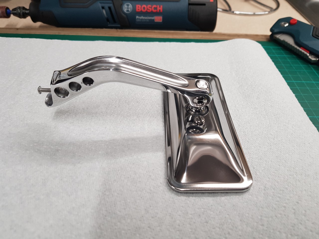

So the search was on to come up with an alternative method of fitting a suitable rear view mirror.A fellow TM’er made up a bracket from the windscreen frame and affixed a mirror to this (sorry,I can’t now find the link….) but I thought it looked the part.
I sorted through my bits box to see if a suitable bit of SS or aluminium bar was fit for making a similar bracket but any pieces I had looked too thin and would (I suspect) have vibrated too much.
A trawl of Amazon resulted in these -
which are ‘cheap and cheerful’ replacement motorcycle brake and clutch levers .They are billet aluminium which is then anodised.
A lot of measurement and head scratching plus the mini angle grinder and a few deft file strokes resulted in this -
I didn’t like the anodised finish on the original lever much so removed it (with some soda solution) then machine polished it all to a mirror finish.The original mirror I bought was fitted to the end ,complete with ball and socket adjustment and secured with a cap head ,polished bolt.

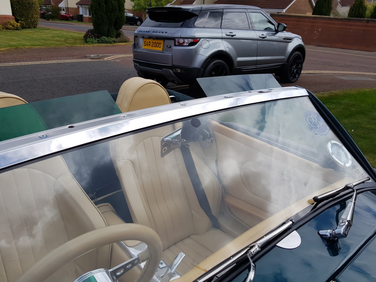

Fitting has involved a drilled hole to the top of the windscreen surround (stainless steel and very, very hard!) and a countersunk ,button head s/s bolt.The shape of the bracket holds it firmly in place even with only one bolt and the resultant mirror is rock solid….result!
I quite like the look of the three drilled holes in the bracket as I think they compliment the steering wheel
Interior view ^
The Garmin Dash Cam. now fits neatly behind the new mirror arrangement and seems to record well .It is wired via the ignition switched Live and has a seperate on/off switch so it can be disabled if/when necessary.It works very well and is ,I think, as discrete as these things can be…….
Front view ^
