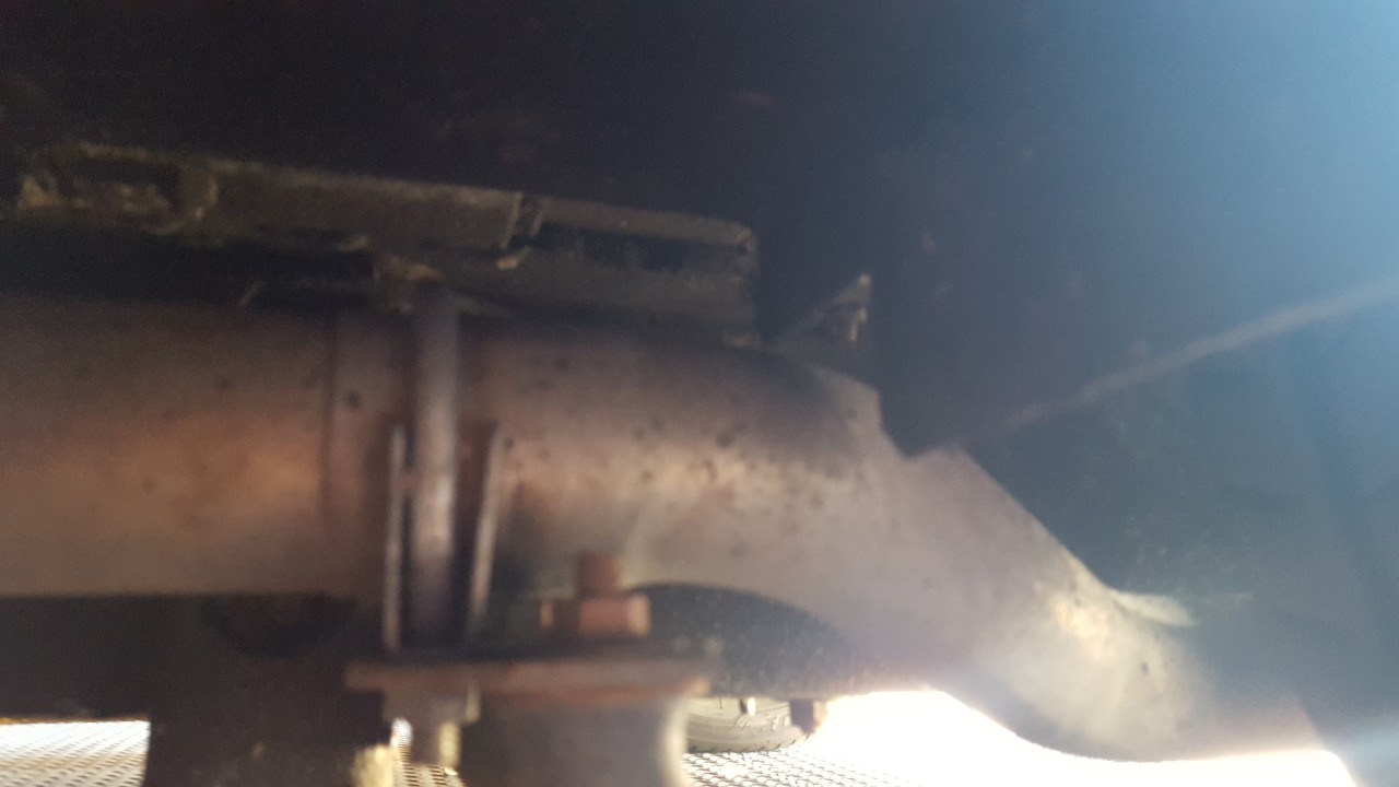

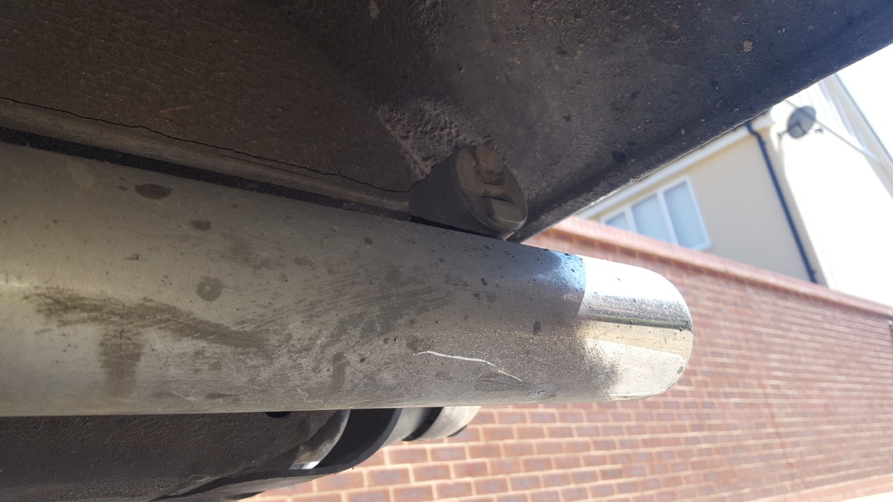

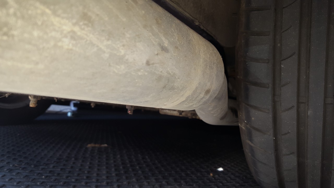

MMC as promised here is a my 06 3.ol Roadster. The exhaust are definitely handed they kink inboard before the rear wheel and the hanger for the rubber doughnut is inboard.
I hope the photos makes sense.
