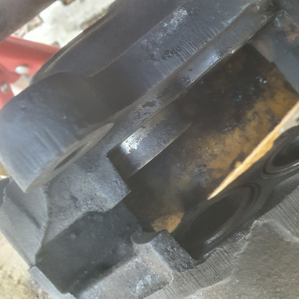

SAE, as per Richards post & link above, very often spares stockists won't list Morgan parts, but in your case you should have the Austin Princess calipers & parts for these are readily available

Did you test only braking strong with the handbrake to make sure that there is no problem with the rear? (brake cylinder or "axle sealings")

Just following on with this post, does anyone have any thoughts on these.
https://www.ebay.co.uk/itm/NEW-UPGR...461286829?_trksid=p2349624.m46890.l49292
They wont have the stainless inners, but with my pistons looking like this, its definitely time for a change.
The vendor has offered to let me buy and try, (dry fit) and return if not suitable.
