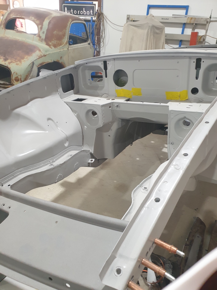

Hi Everyone,
I went and visited my car to see the progress. They hope to have the body ready and painted by mid April and returned to the mechanical workshop ready to start fitting the engine etc. So hopefully more pictures in about 6 weeks but for now here are a few of the body being worked on.

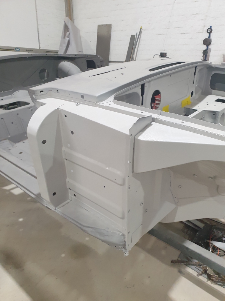

Engine bay is ready for the engine. The top slam panel is being replaced with new because the Radiator Duct was replaced. By using the 1974 to 1980 parts in the front gives an extra 15 to 20cm of room for the engine, the MX5 based engine will fit but maintenance is easier with more room.

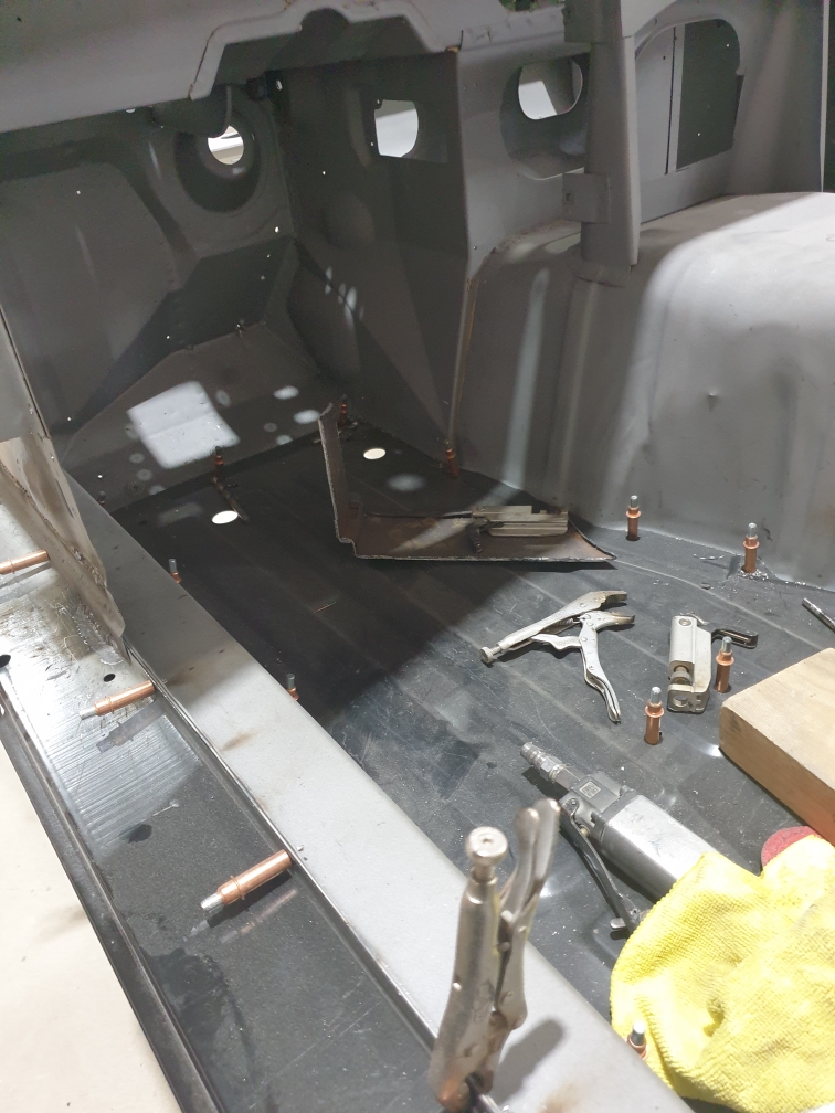

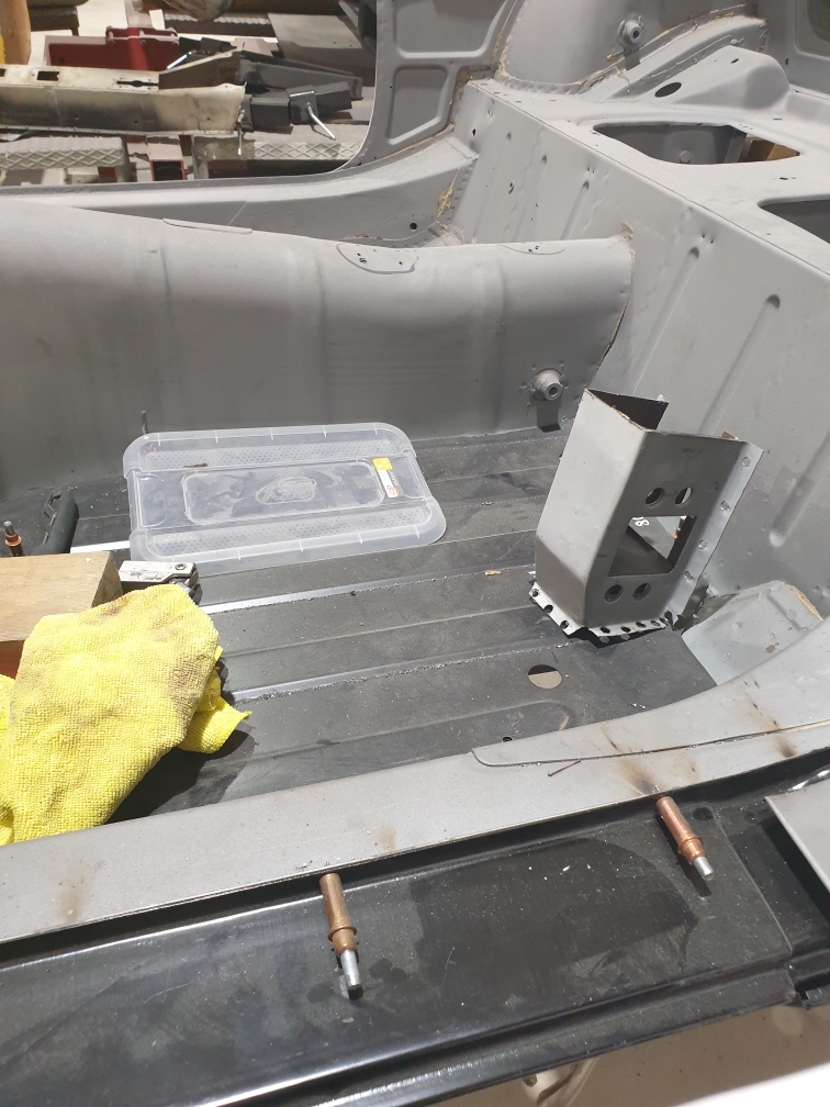

The passenger side floor and sill was in better condition than most MGB's they have worked on but still had some dents plus rust so they decided to replace them.
I was told most places when replacing the sill will leave the frame for the door hinges alone and cut the sill. My workshop prefers to cut out that panel out, fit the sill and then replace the panel, not only do they think it is stronger it also means they can get a good look inside to make sure there is no rust inside.

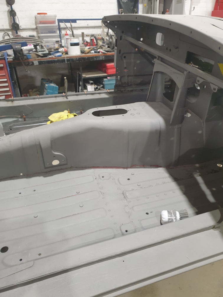

Drivers floor was perfect so left alone.

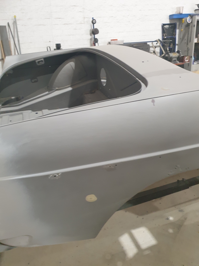

Drivers sill also prefect apart from a few small dents at the front that will need fixing
Boot area nice and straight.
