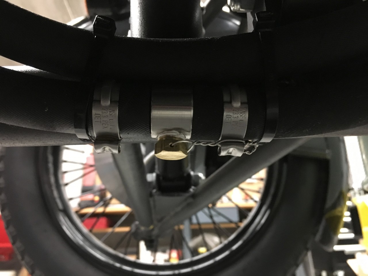

While I was at it, I also installed the Engine Oil Drain from morgancustom.net for future ease of oil drainage.

If you are wanting to install a drain in one/both of the oil lines, you might want to check this out:
https://tinyurl.com/Drain-Port
When I bought one a couple of years ago, I found a stainless one. Drilled a solid brass NPT plug for safety wire. A little more compact and IMHO elegant than the blocky one offered. I would also add that any of these should be inspected for burrs at the end of the tapped thread so none come loosed and cause issues.

It is nice.
With Morgan Customs drain you can get a wrench on both part.
