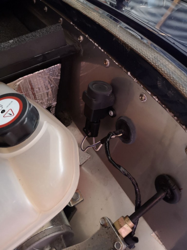

Originally Posted by Mark666
HI Guys,
Only had my 2015 Plus 4 for a few months and never heard of this "Inertia Switch". My handbook says it's a Red Exclamation Mark and is only fitted to a Plus 8, so no help there.
Is it something fitted to older models of the Plus 4?
Regards
Mark
I understand it to have been a legal requirement for a great number of years it's to cut the fuel supply in the event of an impact to cease fuelling a possible fire situation. They are sited in my experience under the bonnet on the passenger side near the firewall and are around 2" square with two electrical connections and the front of the switch has a rubber covered reset button.

I have something fitting the description, see pic.
Learned something today, Thanks
Mark

Yes it should be on the bulk head by passenger side above the wiper motor.
In this photo where I am siphoning the header tank to change out the plastic t piece for a SiFab metal one it is the black square behind the hose as it enters the tank
