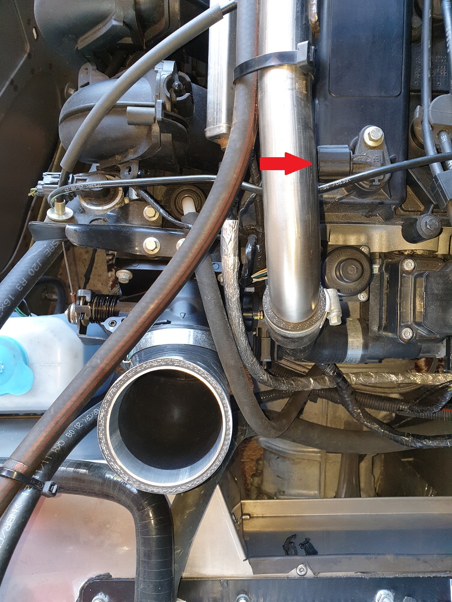

Depending on access Rog, you might get away with cutting the hose shorter around the jubilee clip with a Stanley knife, then remove the clip, slot it along the length, peel it off, and shove the hose further on. You might only lose a few drips of coolant.
That’s a clever tip Dave thumbs Access down there might be a bit of an issue but I will try that first out of interest. Draining it down is not a problem, I can walk under my car in the garage smile
Cutting the hose is probably the only option. I thought about getting the stainless tube out and bending it a little but it fouls the camshaft position sensor connector too so little scope to move it over.
It’s on my rainy day list so will report back.

My hose also fouls the plug in the same way. There is another plug 180deg opposite on my Duratec which will not allow the hose to be moved inwards at all. It seems that the hose could be modified to avoid both by routing it back towards the bulkhead and then make an S bend to connect with the block. All of this is beyond my skills and so I'll keep an eye on it and make it a service check when it goes in for MOT/service.

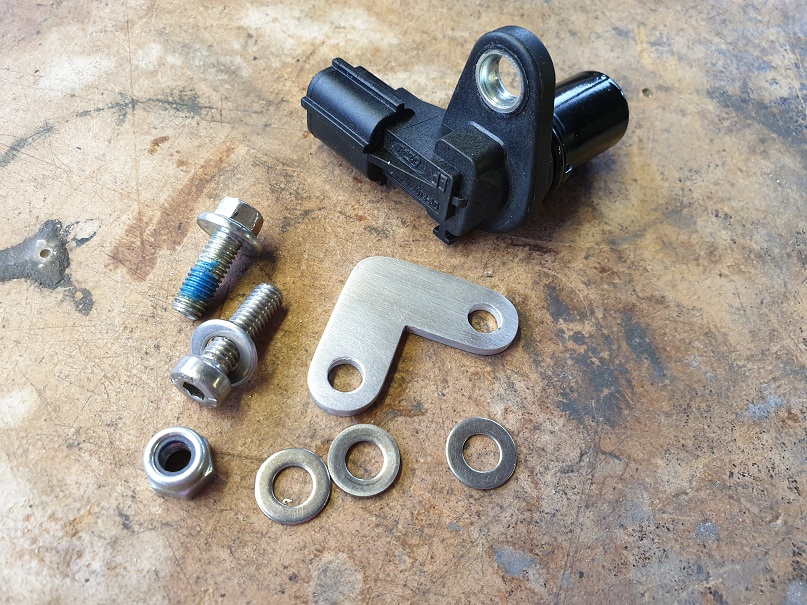

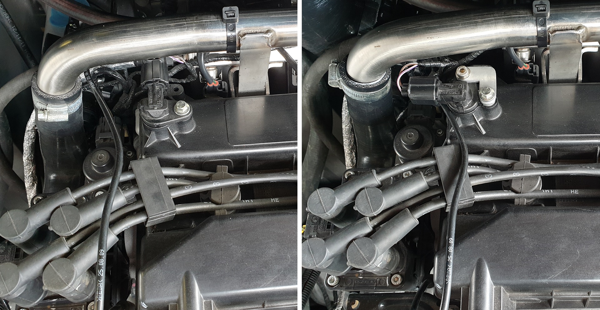

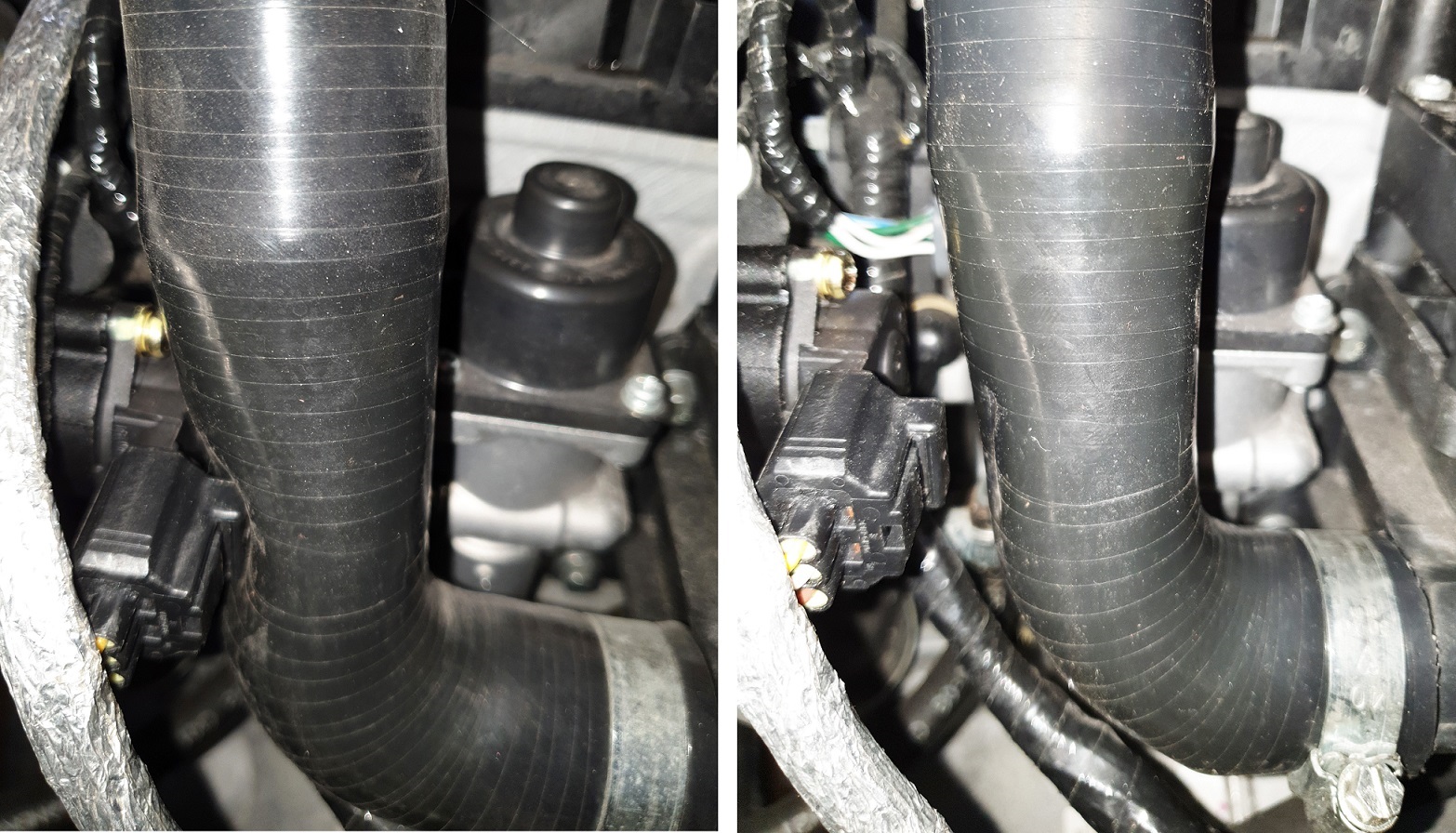

Eventually got around to sorting this. I decided to move/bend the stainless tube away from the throttle sensor before trimming the hose.
As the tube was hard up against the camshaft position sensor I made some room to move it over by rotating the senor 90 degs. Figured it was probably only an inductive device so should be ok (and has not thrown up any error codes so far after a couple of decent runs).
Some before and after pics
I trimmed about 20mm from the horizontal leg of the hose. As well as cooking the TB it was probably impeding the coolant flow too.
Cam position sensor rotated.
Had to knock up a little bracket to secure the sensor in the new position.
