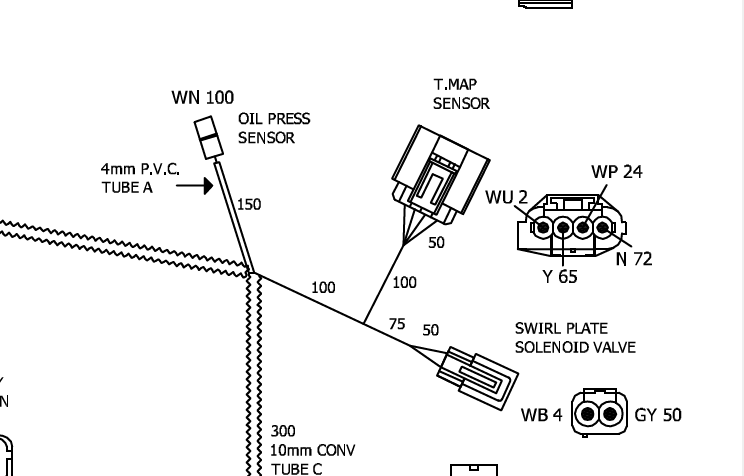

Howard's photo makes sense of the wiring diagram which shows the Oil Press Sensor lead in a 4mm PVC tube
