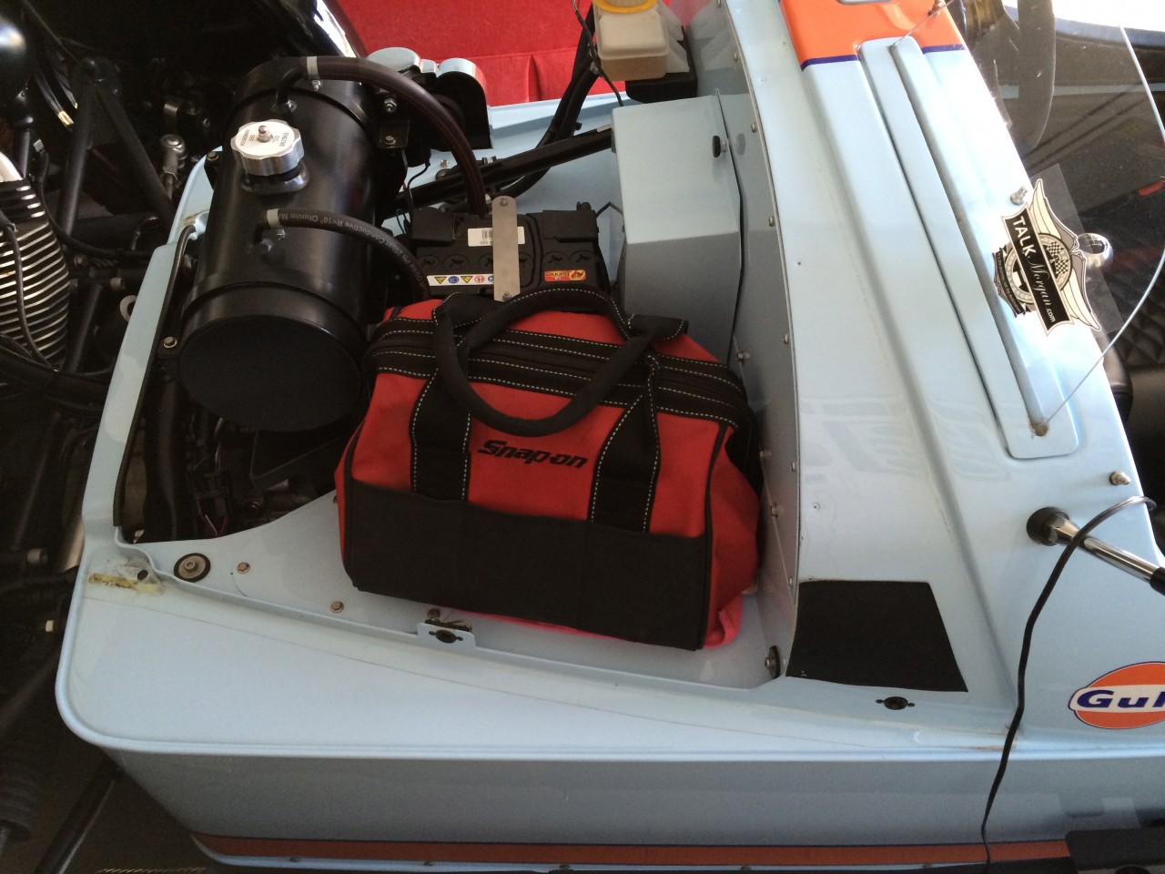

No need for expensive under bonnet storage. When you get the car find a zipped bag that fits on passenger side next to battery & sit it on some gripper mat. You dont want it touching the hot oil tank. The supplied toolkit will fit under the steering column below the brake reservoir, again on gripper mat. You can make yourself a parcel shelf for some interior storage out of wood. Attach it to the underside of the panel where you have sat your new bag. Alternatively make or buy a pouch to fit on the lower side of the panel in front of the passenger. Several on TM have done something similar.
When you get the car if you are long legged make sure the pedals are located as far forward as possible, a spanner job. Consider a steering wheel spacer to give you bit more room to get your foot off the clutch & raise the front edge of the seat with some wood under the cushion.

I used the very same bag shown in Marmots "many options" picture bottom centre on green car. Its a fishing bag from a supermarket after a tip on this forum. Cheap, loads of pockets, just pick it up & who is going to see it under the bonnet?

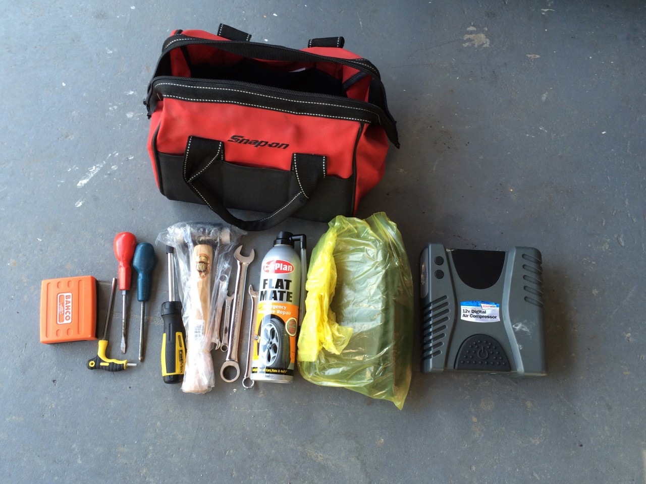

The toolkit which I carry is Allen keys metric & imperial, flat, pozzy & phillips screwdrivers, pliers, 8,10,13,17 &19mm + 7/16, 1/2, 9/16, 11/16 & 3/4" spanners.
Insulation tape, cable ties a spare inner tube and a tyre inflator. Also on long trips a fuel pump.
Rule of thumb, the more you carry the less you will need. [Linked Image][Linked Image]
