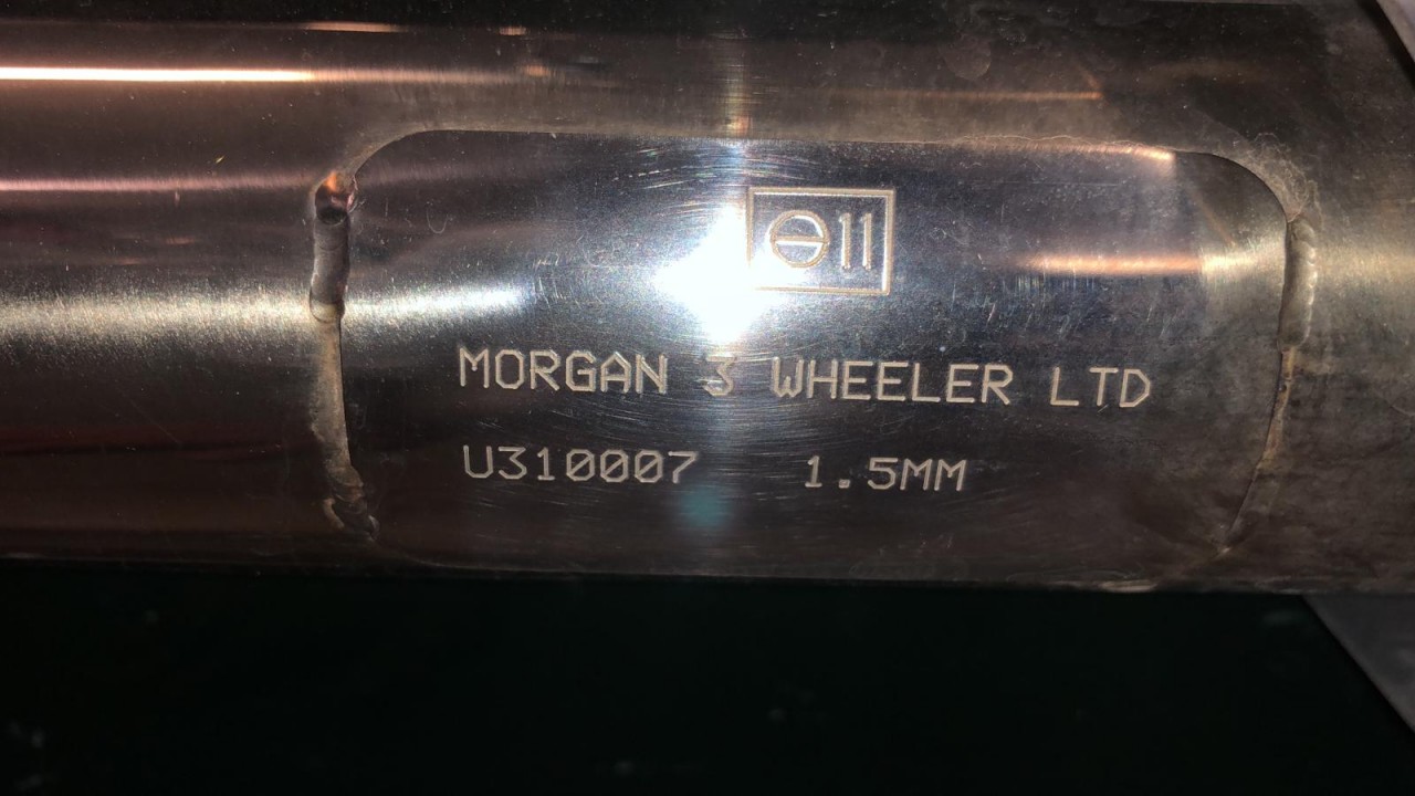

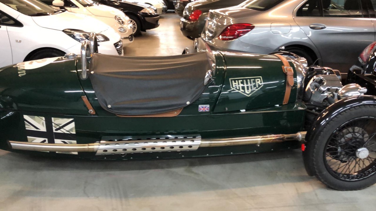

The other one is the one I show you in the pictures, and they have an issue with it. It's a 2013 unit, clearly purchased by someone here in Spain a couple of years ago as second hand (because of the plates). And while this happy owner was enjoying a driving day, he was stopped by our Guardia Civil (in charge of traffic when you're out of a city / village). He got a nice expensive ticket because the car was "too loud": 105 db to be precise instead of the 98 db that the MOT card says. listening
This new second owner was shocked and took the car to the garage trying to see why this is happening. And the garage is also a Little lost as the car seems standard.

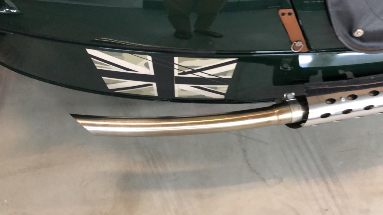

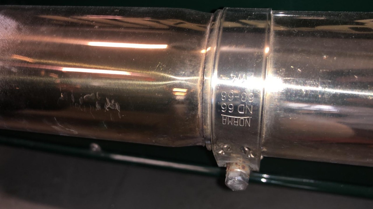

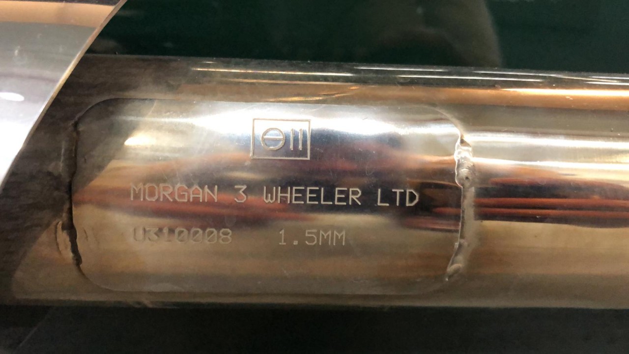

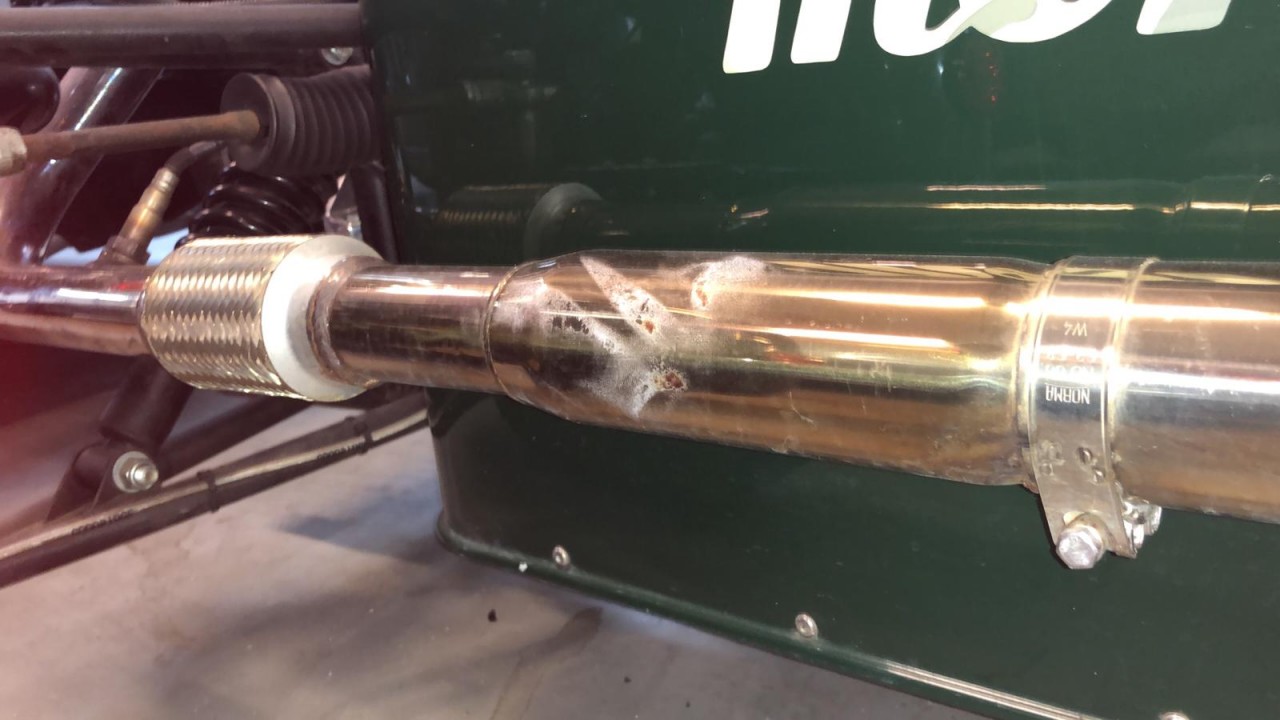

But when I look at the car and see the pictures, to me the exhaust is NOT the original one. First because it's curved to the end following the shape of the boot, and second because it looks quite thin and the plate with the "Morgan ID" seems to be welded so I suspect it was taken off the original pipe and welded on that one.
However, I'm obviously not a specialist on 2013 units, but some here please give me your opinion looking at the pictures. Is this the original standard exhaust or a different one that may be causing the high db level?

The silencer looks to be original, but the tail pipe is not, it should be welded on to the silencer, from the picture it is fixed with an exhaust clamp. This may be because it was cut off to facilitate bending, but baffles may also have been removed.

That's my bet: the previous owner removed some bafles from inside the pipe. If not, there should be no reason for the car to be much louder tan the specs.

Agree with the others, almost certainly had some or all the baffles removed as well as the tail pipes altered. Is there actually a baffle box under the heat shield, it looks a bit narrow under there? I do like the curved tail pipes, some of the Swiss M3W's have them as well.
