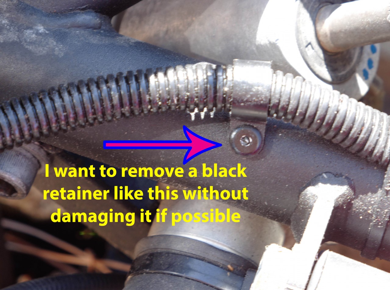

I am currently in the process of changing my Lambda Sensors. I have bought the Bosch universal ones, where fitting seems fairly straightforward after you have wired the weird connector block. The only problem I am having is removing the black headed ?rivets? holding the wire locating clips onto the chassis. I don't want to gorilla these and break them. Is there any way of removing these other than drilling them or levering them out. It would be very difficult to get a drill into the location of the clips for the Lambda sensor wires. Below is a photo of the type of clip I mean. This is one on a headlight cable but the clips on the lambda sensor wires are the same.

I don't know of an easy way, I just drilled or filed the heads off and replaced them with self tappers to hold the P clips in place. I would rather the chassis tubes had not been drilled and cable ties had been used instead but that's not the Morgan way.

When I changed the plug leads on mine the leads were help by similar plastic P clips which were pop riveted to cross tubes. I just drilled off the soft head and the remaining rivet dropped inside tube, sometimes they need a push though. The same P clips were then re-used to secure new leads with fresh pop rivets into same holes. I did add a stainless washer under each rivet head though to spread the load against the plastic.

They are pop rivets the only way is to drill them out or Dremel if the mandrel is making drilling difficult.

I used a long slim cold chisel and cut the heads off. I have positioned the connector blocks that Bosch supply with the universal Lambda Sensors, where the P clip was and held that to the chassis on either side with a cable tie. I have a pop rivet kit but the pop riveter I have in France is a big two handle double leverage one (looks like a big bolt cutter) for doing the 6mm stainless rivets on the bodywork, so I cannot get it in to where the P clip attached to the chassis. The connector block is so that you can move the original quick disconnect loom plug from the dead lambdas by cutting the old wire and connect it to the new lambdas. The wire leads were all the same colour on the new (2 white heater wires and grey and black sensor wires) as the original. From appearance, the old lambdas were also Bosch. Made life a lot easier than the Magneti Marelli ones with all white wires. The first one I did seemed a real fiddle but once I had worked out a better order to do things, the second one only took me about 30 minutes from start of removal to all connected and secured. Now the next job is to replace the coil pack and plug leads, then hopefully my misfire will be history.
