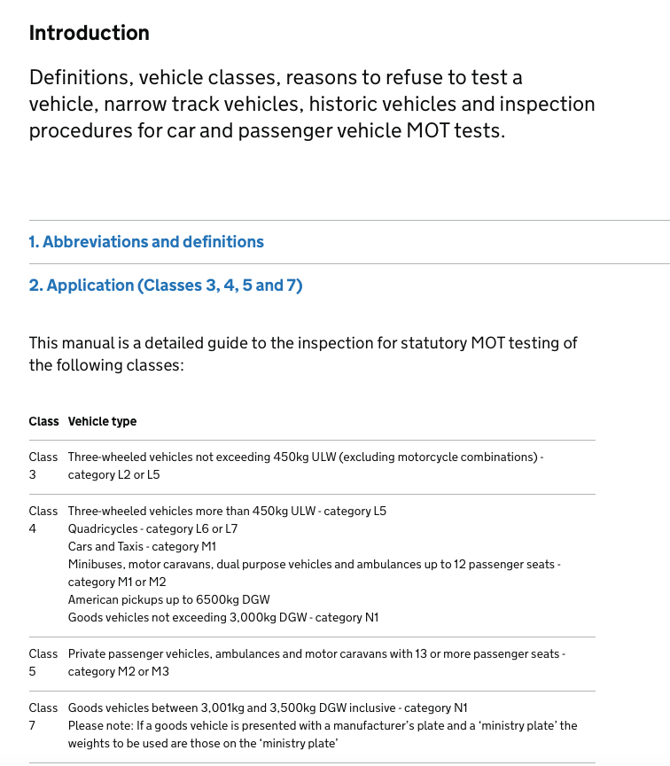

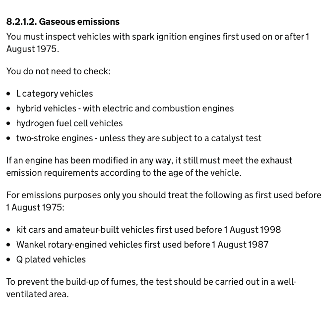

Emission testing is not part of the MOT Test see excerpts from MOT manual below.
