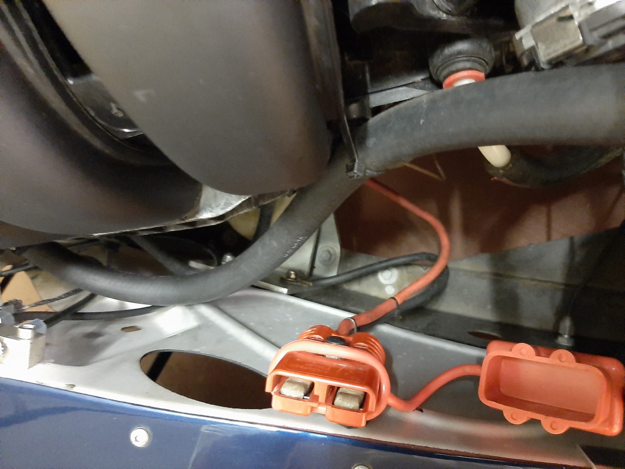

I went the Anderson connector route one end on the starter motor the other on the engine mount and have various length tails, one of which I carry in the Morgan
Tim

Tim Crump #662448 15/09/20 09:26 PM
Joined: Aug 2019
Posts: 793
Likes: 144
Joined: Aug 2019
Posts: 793
Likes: 144
That looks a great solution. Feel another little jobby coming up.
