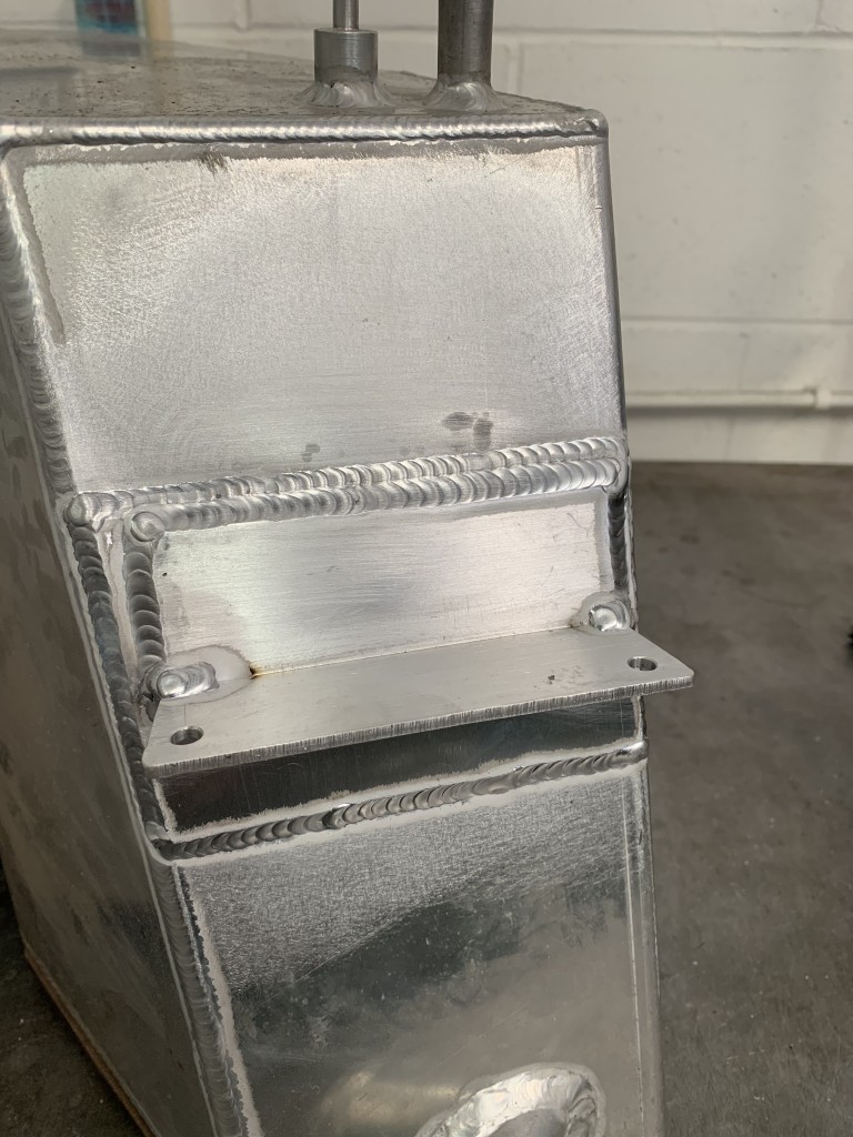

With the chassis failures hopefully out of the way, of all the irksome faults remaining with these cars, some I actually enjoy fixing in a perverse way. However this is the one that scares me the most. I’ve spent a lot of my life working with fuel accidents in the marine and O&G sectors and gasoline is not to be messed with. A rear end shunt on a car with a cracked fuel tank at the mounting doesn’t need a rocket scientist to work out what could happen next! I seem to remember an American car called the Pinto that had a habit of bursting into flames and toasting the occupants after a rear end shunt, eventually that was the subject of a major industry ethics and reform movement that didn’t do Ford much good.

The cracking fuel tanks and a solution to prevent further cracking was mentioned in March 2019 http://www.talkmorgan.com/ubbthreads.php/topics/565029/2 and in an article in the MTWC Bulletin magazine in May 2019. I can report that the preventative measures to stop further cracking of the support brackets propagating through the weld and into the tank, seem to be working well. If the fixing brackets are modified as detailed and the retaining straps checked for security periodically, the tanks shouldn't crack. Not many M3W owners are doing the mods as Morgan seem to be doing a good trade selling replacement tanks to M3W customers out of warranty but that will just result in another cracked tank eventually.
If the owner of a car with a cracked tank would like to take it up with DVSA they may be interested and issue a recall? There has only been one recall for the M3W and that was for early model brake pedal failure, none for the known chassis cracks, that DVSA are also aware of.

I can repair them....
Simon @ Sifab.co.uk

That's a great repair Simon and how it should be from the factory.
I will be carrying out Planenuts solution as a preventative measure when i get my car back.
