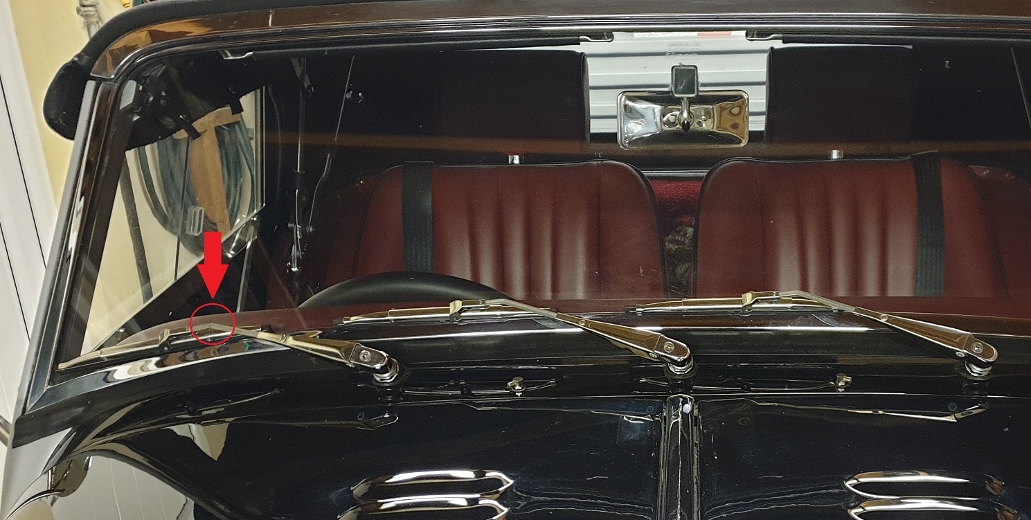

I agree too, much better quality. Why doesn't the factory fit these?
I did fine tune each arm by bending the bit in the pic below but they function and park beautifully.

Thank you to all who purchased The 7” blades ,very often the arms need a slight tweak on the bend to ensure they lay parallel when parked ,you would think the dealers would pick this up on PDI and sort it out .
It’s quite amazing how different the wiper arms are bent to fit the Morgan car ,or not as the case may be in some cases.

Roger that is perfect parking .
Owen yours over lap on to the bottom of the windscreen fame .
It may be possible to bend the arms to get them parallel with the bottom of the screen then adjust the arm on the splines to re position.
but the arms are different ,no screw to lock them in place so It must be on a splined taper wheel box ,it’s never straight forward with a Morgan .
Perhaps leave well alone if they work ok ,the rubbers can be easily replaced .
