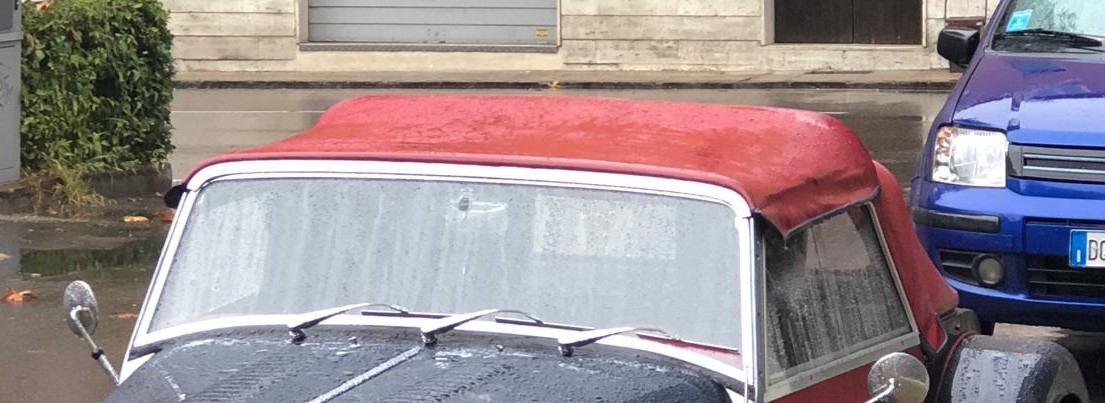

My idea was to use some neoprene to close the gaps between the sidescreens and the doors, i think most of the air comes from there.
Plus i've noticed that my roof doesn't really closes all the way on the windscreen, here's a picture:
I have no idea why this is happening but i'm blaming the roof seal that is way too thick to correctly fit the windscreen.
Am i wrong? Are there other ways to improve the sound deadening?
My car is a 2009 3.0 Roadster with sport exhaust (yes, it drones at 3k rpm)
Thanks in advance,

Roof seal to windscreen looks perfectly normal to me.

I have used self adhesive neoprene strip to seal off the hood to windscreen join. Another attempt at sidescreen draught sealing is due though.

My windscreen seal on the bar that mates with the windscreen was deformed and over time had bunched up in the channel. I cut a little away and stuck the remaining part back with araldite clamping it for 24 hours to make sure it stuck properly.

The fitting of the roof to the wind screen looks normal to me too. I am not sure if it is wind noise that is bothering you, or wind actually entering the cockpit. I do not think there is much you can do about the wind noise. The Morgan is far from aerodynamic, so wind noise is part of the game. If the sidescreen is not snug against the A-pillar you can bend the alu bracket a little (use a hydraulic press or a vice, do not try to bend the screen when fitted to the door). You can put some neoprene or rubber gaskets here and there, but I do not think you will achieve much.
And the exhaust droning, I am sorry to say, is the price one pays for sport exhaust. I know many a sports car driver that has changed to sports exhaust - and changed back again.
As for the roof/screen fitting; looks ok as I said.
A Mog is not a motorway animal, IMO. Do as you did on you way back, choose inner or B-roads, take your time and enjoy the scenery. I am sure your good lady will appreciate that.
