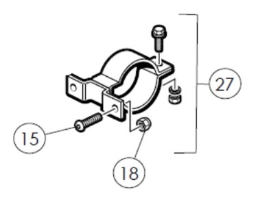

It's completely loose, but attached to its support. Let me explain it better: the fuel filter, as per below image, is fixed by a round bracket. And this round bracket is fixed via a Ω-shaped steel piece to the plate at the back of the seats.
I video is a hundred times better that any description: see this https://www.youtube.com/watch?v=HahSV6XoR6E.
Is this normal? I don't think so! ooo
In a car with so much vibrations and where we all try to reduce the rattles, this mounting of my fuel filter looks like a bad joke... mad2

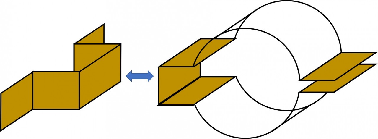

As per the drawings and the pictures that I've received, it looks like the two pieces are welded back-to-back, and not at the inner face of the contact. Like in this drawing
If this is how it's made, if the weld spots fail the filter would directly fall (not good at all. I prefer it hangs loose from the support than falling in front of the mudguard hanging just by the pressurized petrol pipes).
So, the only way that my filter ended up hanging like this, is because it was mounted like this, not broken. I might be wrong and it's welded the other way round, but right now all indicates the opposite.
As you say, it's very simple to unscrew, drill and secure with nice bolt and nut. But My M3W is still under warranty and I have to take it to the dealer to solve other issues such as the Bevel Box leak. I prefer them to deal with the problem.
BUT: if once it's repaired I see that the new support is welded as I suppose it is, I may then drill and reinforce with a bolt / nut so if the weld spots fail again it stays fixed by the bolt and nut.

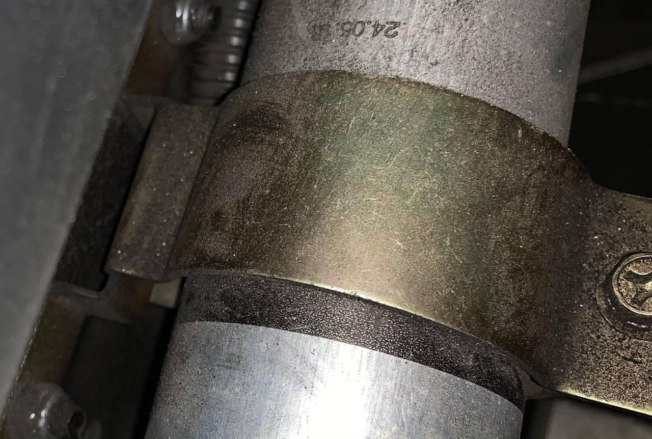

Javier - I just checked my fuel filter mount, which is happily rock solid, and on mine at least the two pieces are "looped" together, so that they will fail-safe in the same way that yours has. It is a tricky area to photograph in, but here's what it looks like as best as I could capture it.
So while this is another case of poor welding (I had a weld fail on the mount for the ignition system in the first few weeks of ownership), it is possible that it left the factory intact.
