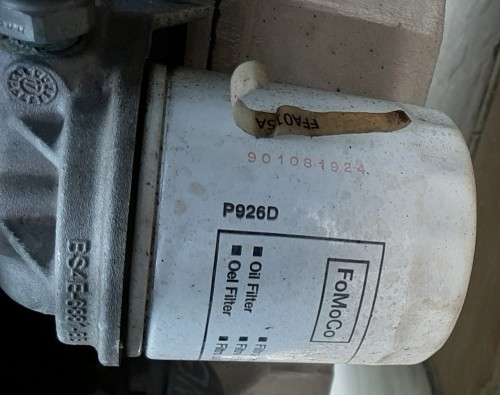

Oil filter that is on. FO-MO-CO Part No P9226D
AA 6E-6717AA .No one local can supply me with one
Tried eBay for a cross section, part number coming up
As a air filter?

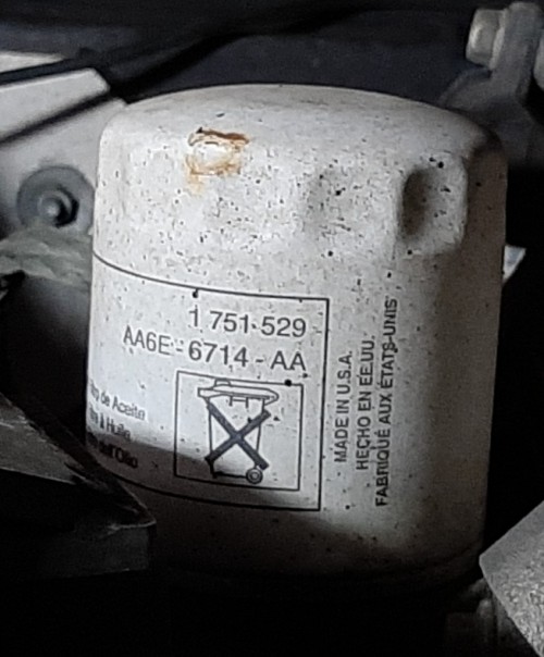

Hi Stuart,
I have the Duratec Plus 4 which uses oil filter ref: AA6E-6714-AA. As you say, the ref you quote ending 17-AA doesn’t seem to come up on an internet search. Perhaps you could ask a Ford dealer who has a parts department for advice in this? If that fails and you have bought the car from a dealer who does Morgan servicing, ask them what filter is applicable.

I have a 2018+4
The handbook says for oil SAE5W30
Oil filter
OEM AA6E-6714-AA
Morgan part ref SV130009
I reckon that these are equivalents
Bosch P7203 EAN: BOSCH 4047025654982
Fram FRAM PH9566 EAN: FRAM 2259118743440
Mahle ORIGINAL 70582038 EAN: MAHLE ORIGINAL 4009026887554
Most websites don't allow you to search parts for a Morgan so try Ford Focus Mk3 ST 250 (2016) when looking for engine parts.

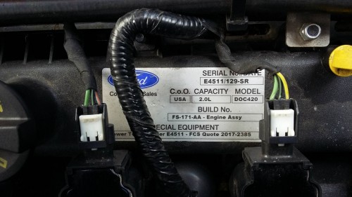

How do you get the engine type?
Here is the label on my engine

Hi Tim,
Ah! My mind’s eye has caught me out. I’ve seen some info on the block at some time but am at a loss at present.
But, I have my engine code in the handbook. It is also stated on the Certificate of Conformity, item 21 that I received with the car.
Sorry to mislead and hope this I useful.
