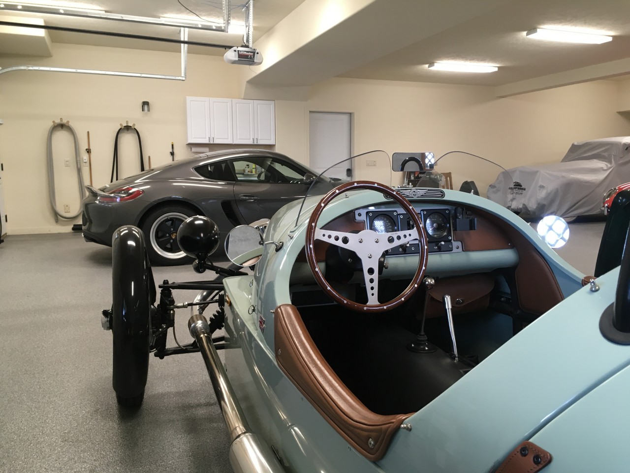

I've posted photos in other threads that show it, but I'll see if I can find a representative one.
Steve
Late 2012 M3W
Joined: Feb 2018
Posts: 807
Likes: 38
Online NoMood
Joined: Feb 2018
Posts: 807
Likes: 38
Here's a couple of views. 2" pipe to the muffler, 1 7/8" after.
I do have other mufflers (Porter brand) which I will fit sometime soon.
Steve
Late 2012 M3W
