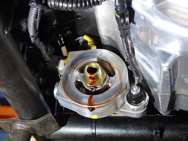

So I was changing the oil and next to the filter i discover a wire hanging down after I changed the oil filter. Everything looks to be in order - nothing exposed - but this thing is hanging. I can push it in to a nut just outside the filter but it doesn’t feel right. And it’s not threaded. Any thoughts? Can’t figure out how to post a photo small enough to share 😩

The wire could be the oil pressure sensor wire as it is next to the filter. In the photo (this isn't quite like the standard set up as it has a sandwich plate) the pressure switch is the silver and black item at about 4 o'clock in relation to the filter housing, with a wire going to it. If it is disconnected the oil pressure light will not operate correctly. For info there is a section on posting photos in the "Welcome Forum" at the top

I would think it is the oil pressure switch, i broke mine when changing the filter

Thanks. That’s definitely it. It looks like everything is hooked up correctly but the whole steep just needs a place to live, and I must have knocked it off while changing the oil filter like Hugo. I think even taping it would work. Hugo?

I had to replace the oil pressure switch as the nut had snapped off and the spring had come out swear
