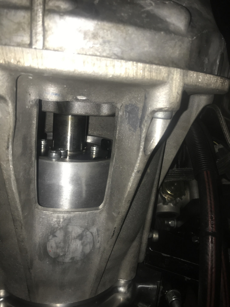

This will give you an idea of where to aim for with your access hole. This rectangular hole I have since cut out is needed to change Phil's new easy change Centa rollers that you have no doubt read about. The round disc at the bottom of the picture was a factory access hole that I have filled with JB weld.

Its a good while since I attended Phils to do the Centa mod, so some details are vague , but I do remember the Centa coupling barrel being reversed so insert access is possible from the rear end , making me wonder if you can even get at the inserts from a new hole without deep changes ( i.e. doing the full mod ).
As ever I am just being cautious. A quick call to Phil will confirm.
