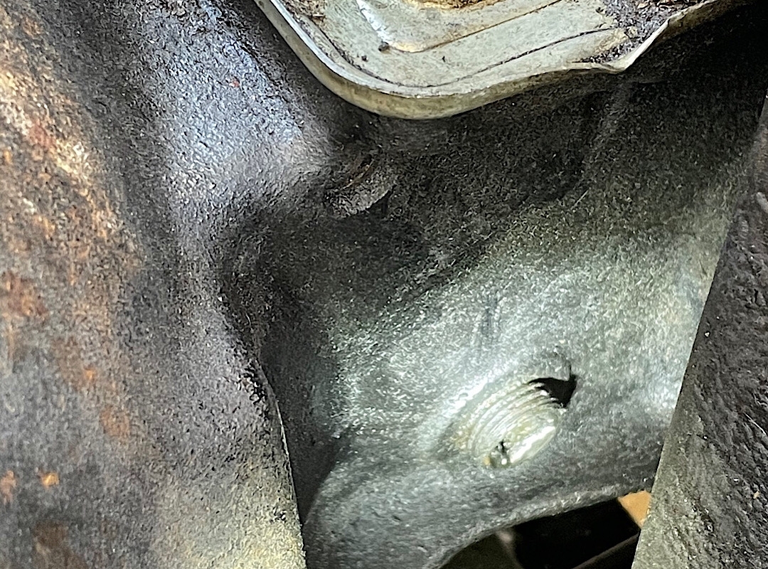

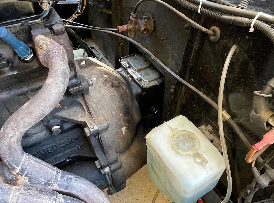

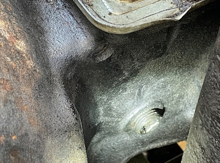

Checking gear box oil
Searched everywhere for gear box oil fill/level plug.....is this it? I didn’t imagine it would be accessible from under the bonnet but checked for access in sides of trans tunnel and no luck.
Neil.
Ps mmmmm pics not showing in preview so fingers crossed.

On my 1972, the gearbox filler is on the right/drivers side of the gearbox. There's a cut away hole in the transmission tunnerl near the clutch pedal, with a standard four sided filler plug.
I've had seen others where it is on the opposite side!

If it's a 5 speed type 9 mine's on the passenger (left) side at the front near the bellhousing.
