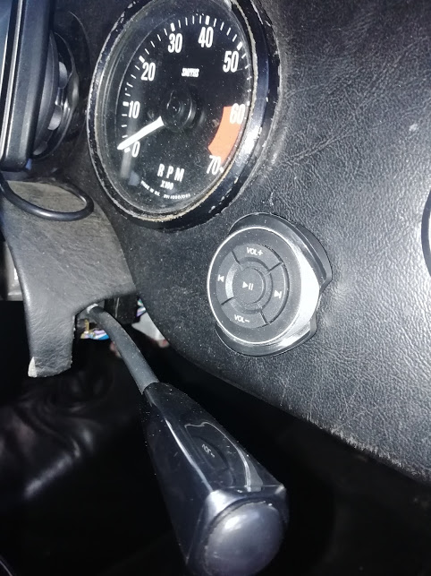

I use Bluetooth through my phone.I don't have a stereo, but have a large portable speaker that I stick behind the seat. Lasts for hours (over 10)
I do have a little remote unit stuck on the dash, which pairs with the phone and allows me the basic functions of volume/skip/pause, so I can keep the phone in my pocket.
If I was going to hard wire anything in, I'd probably just go for a discreet Bluetooth Amplifier and a couple of speakers.

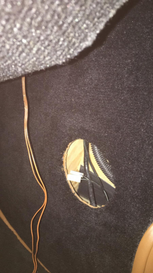

There are factory circular cutouts in the alloy panels behind the carpet in the footwells for 100mm speakers. The carpet is easily cut out with a Stanley knife and the speaker cables are already there.
The connector blocks for power and speakers are already behind the radio cutout too. I have a Sony Bluetooth Radio with USB and my Iphone is used as the remote and works well.

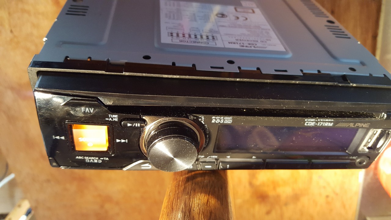

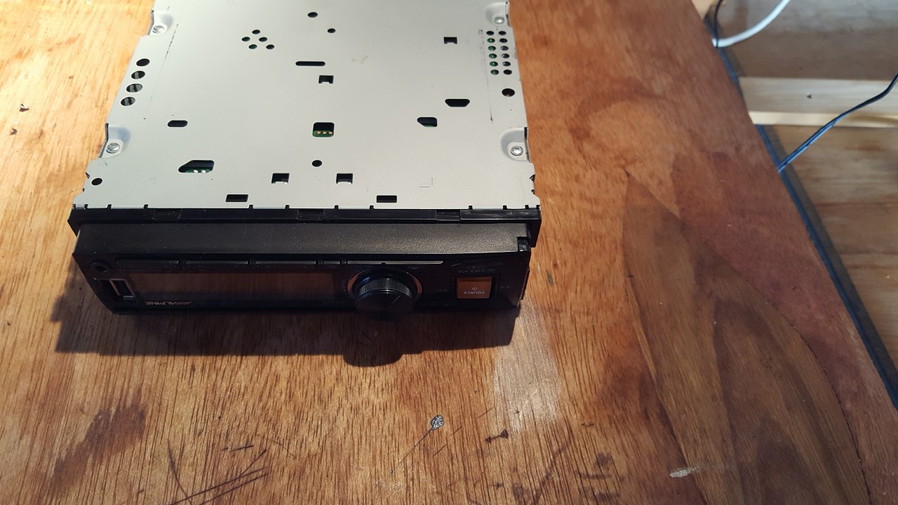

CDs work but can jump. I have an original fitment Alpine radio CD player with USB port which I took out as I have a Sony unit with a remote. PM me if you want to buy it.
