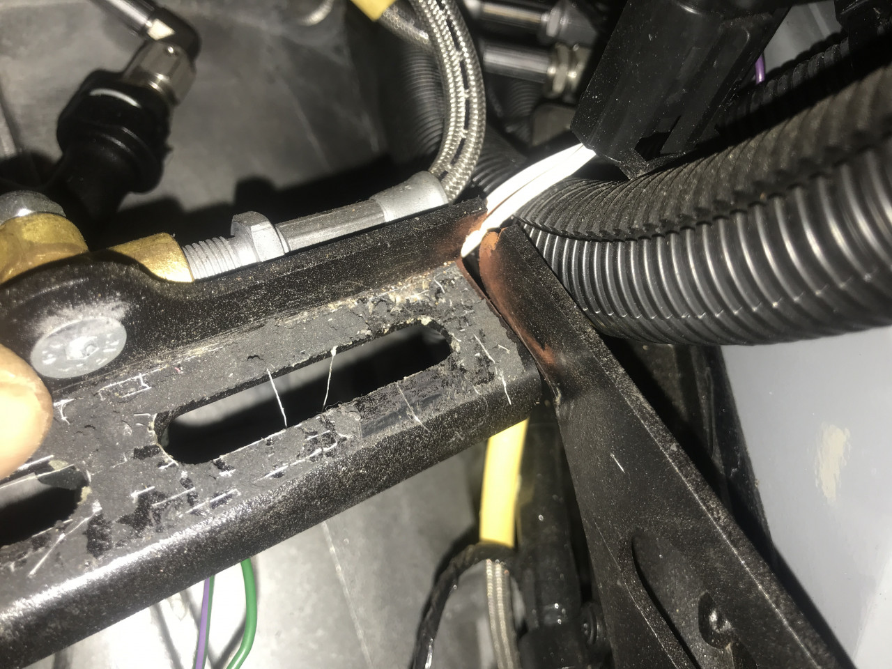

Changing out the battery today for a new one I found the front support of the tray had parted company with the side, not a lot of weld joining them together considering the weight of the battery.
Worth a check next time the battery is out.

Too late, I have welded it up now but will look at moving it as it looks a good ideaπŸ‘
