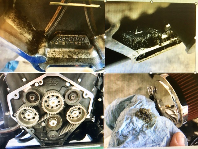

hi my 2017 has both the 2 horizontal slots and the machined standoff in place of the washers.
I took mine off today to have a look at the belt. There was a lot of belt dust. Is this normal or
is my belt about to go bad?

The shavings are normal - you need to check the belt regularly for cracks & clear & clean plus change the belt on condition.

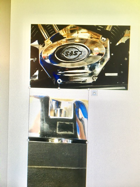

thanks, I cleaned the belt dust and some oil drippings from the inside bottom of the cover.
Mine is a 2017 with 2 slots and machined spacers. Here is a photo (sorry not the best photo)

The belt debris is normal, as Mark says. S&S describe it as "snake skin" and it is the release agent from belt manufacture. There is also a cutout at the base of the cam cover that has been there since the start, probably to let the crank seal oil leakage out. I like the machined spacers on the later covers, I just super glue the washers in place to make things easier.
There does seem to have been a bad batch of belts about and they have shown signs of cracking after just a few thousand miles, well worth checking them regularly. In theory the belt life is 3 years or 30,000 miles (with the vented cover) but "on condition" seems sensible. It is a "safe" engine as the valves and pistons don't try and occupy the same space if the cam belt fails, always nice to know.

Thanks for the picture, I do like that - might have to order one! cheers
