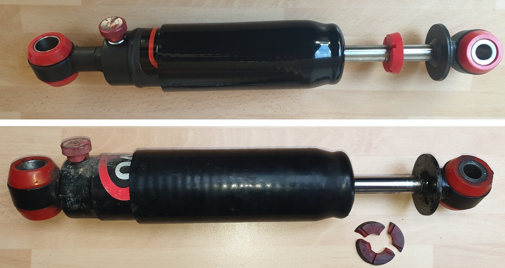

Originally Posted by TBM
I did read that AVO had them, but can't be sure.
AVO’s do appear to have little PU bump stops or buffers. The pics below are with the dust covers slid down off of the fixing eye. The top one is a new and the bottom one is an old one I removed from my new to me car. The bump stop was broken and rattling around under the cover when I removed it (both sides were the same).
