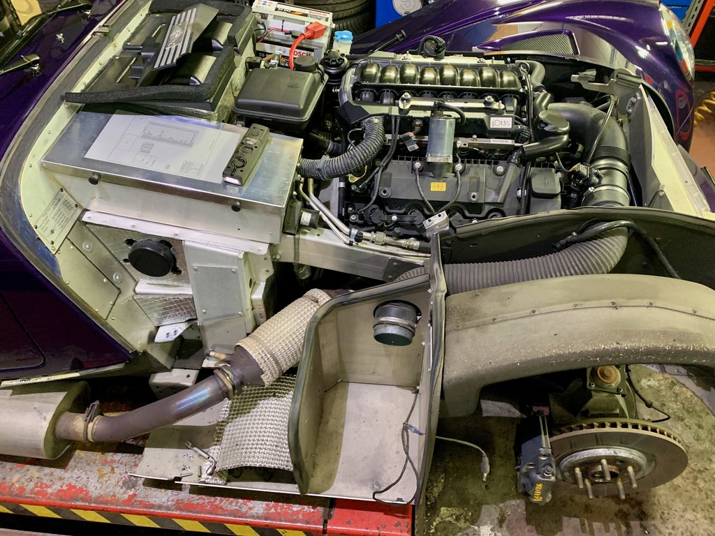

This photo shows on Tarka the hose from the engine bay into the wing and than the air filter housing. There is no inlet from the engine bay or the under the wing.
Tarka is a July 2013 build, not really a surprise cars differ....

Have fun. Here with the airfilter box removed.
You need to:
remove bonnet
remove cowl
remove wing
