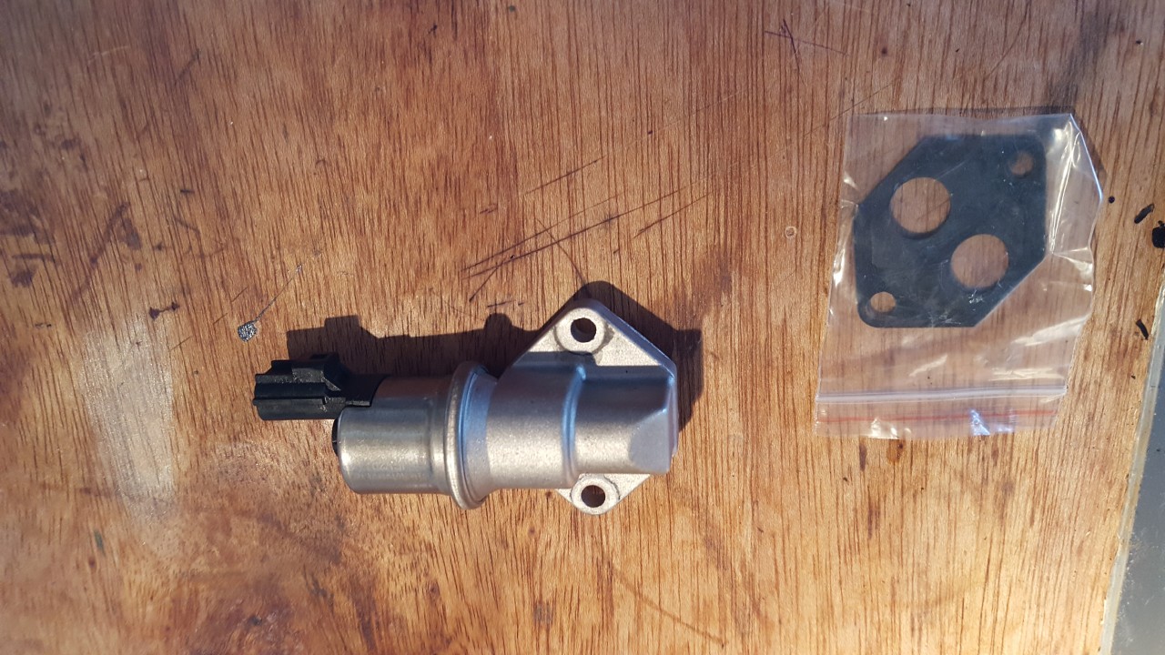

Chris,
I am not. But if you pay me a tenner you can have it.
This what the ebay site I bought it off says
Idle Air Control Valve
Vehicle Shape Year Engine Engine Code(s)
Ford Cougar EC_ 8/ 1998 - 12/ 2001 Petrol: 2.5 LCBA, LCBB
Ford Mondeo MK III 10/ 2000 - 3/ 2007 Petrol: 2.5 LCBD
Warranty: 5 Years
Cross Reference: FORD: 1S7E-9F715-CA, FORD: 1S7Z-9F715-CA, FORD: 4138506, C.I.: XICV78, ERA: 556061, FUELPARTS: IAV189, INTERMOTOR: 14852, LUCAS CAV: FDB1552,
Notes: Weight [kg]: 0, Number of Poles: 2, Length [mm]: 79, Width [mm]: 79, Height [mm]: 79, Operating Mode: Electric, Valve type: AuxiliaryAir Valve
I hope that helps.
John

Thanks for posting the photos John. Mine has different orifices and chambers, and the plug is in a different position so I don't think the spare you have will fit:
