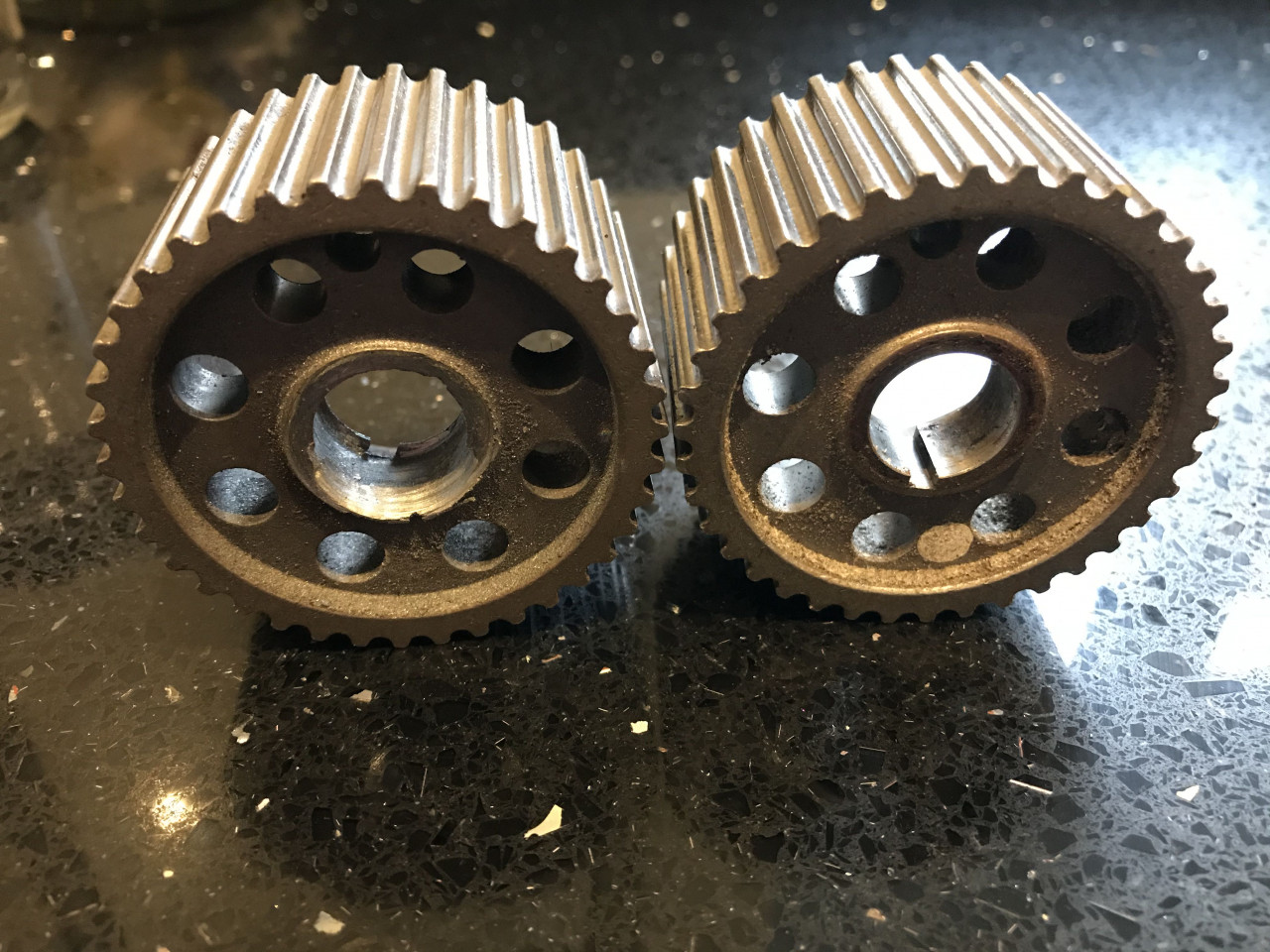

Have a close look behind the cam belt cover - I had similarish symptoms before a cam pulley detached from its drive shaft - after a spirited drive the cam pulley destroyed itself, compare the one on the left ( where the key way is mashed up ) to the good one on the right.
PS I hope its not this - quite expensive to fix !

There's only 1 cylinder affected so I wouldn't think the TPS would be likely. Given the super rich condition I would suspect a bit of detritus in the one injector, not allowing it to fully close. Also see the cam pulley issue as less likely due to the engine running well once the throttle is opened somewhat.
