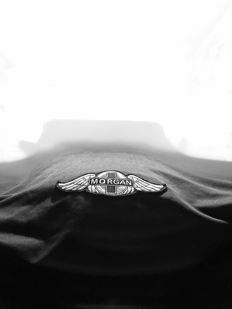

Waiting for the weather to improve…..its been a while.
